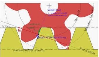

Undercut affects tooth strength. Precision affects running smoothness, noise, and fatigue life at high speeds. They are two different things. Here is an image showing an undercut gear meshing with a rack:
Undercut can be eliminated by redesigning the gear with profile offset, but that increases the sliding action when the gears mesh. Search undercut gears for more information.
3D printed plastic gears will not be precise. If your application is low load and low speed, then design for the fewest number of teeth and use profile offset to reduce/eliminate undercut. If you are designing with SolidWorks, there is a module available for designing gears that makes it easy to specify variables such as profile offset. It's Gearcalc or Geartrax or something like that. The high end gear design package is Kisssoft, but I don't know if it integrates with solid modelling packages.
