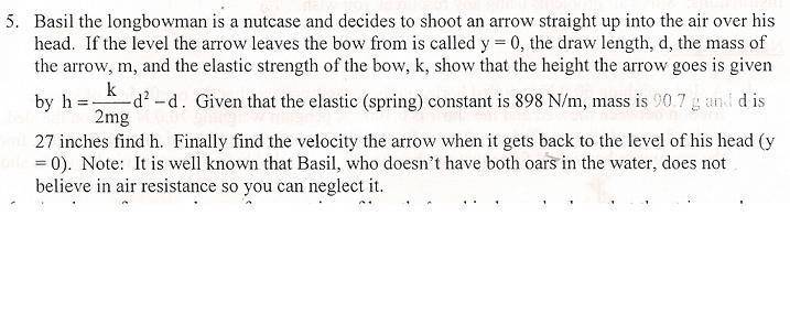

attached
equation in the problem
k = 898 N/m
m = 90.7g = .0907kg
d = 27 inch = .6558m
g = 9.8 m/s
h = [(898n/m)/(2)(.0907kg)(9.8m/s)](.6558m)^2 - (.6558)
that is for the H. when computing this is got 217.55m. I am assuming the way the equation is written out for h in the problem that is how to set it up.
now it asks for velocity.
when it gets back to zero. We will say E1 = E2...
at E1 it is all potential energy and no kinetic. and at E2 where we find final velocity it is all kenetic and no potential?
so then we have mgh = 1/2 mv^2...
plus the top equation in for h
then isolate V and solve.
thanks for any help.

The height of an arrow shot directly upwards from an inital height [tex]0m[/tex] is given by: [tex]h=\frac{k}{2mg}d^2-d[/tex]. [tex]k=898N\cdot m[/tex], mass is [tex]0.0907kg[/tex], and [tex]d=27in[/tex]; find [tex]h[/tex]. And, find [tex]v[/tex] at [tex]h=0[/tex].

the whizz said:
attached
k = 898 N/m
m = 90.7g = .0907kg
g = 9.8 m/s
ok put the two together
That sounds perfect.
