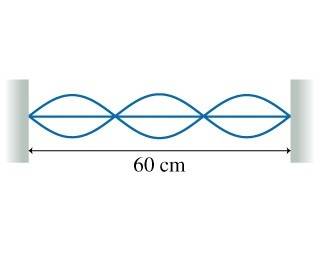

The standing wave in the picture is oscillating at 100 Hz. What is it's velocity?
Velocity=(wavelength)(frequency)
I believe is the equation that applies here.
The wavelength from the picture appears to be 20x10-2 meters.
So velocity should equal (20x10-2)(100)= 20 meters per second
But I know this answer is wrong. Where am I going wrong?

Why do you say that the wavelength is 20cm? Draw a full cycle of a sine wave -- what does it look like?
Also, be careful with your units. It looks like you are mixing cm and meters in your multiplication and answer...?
