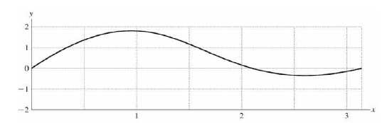

I'm trying to graph the total wave at ##t=0##, and it says I should get something that looks like this:
Graph of y against x from 0 to about 3.2, showing a single smooth curve that rises to a peak near 1.8 at x about 0.9, crosses zero near x about 1.6, reaches a trough near -0.4 at x about 2.6, and returns to 0 at the right edge.

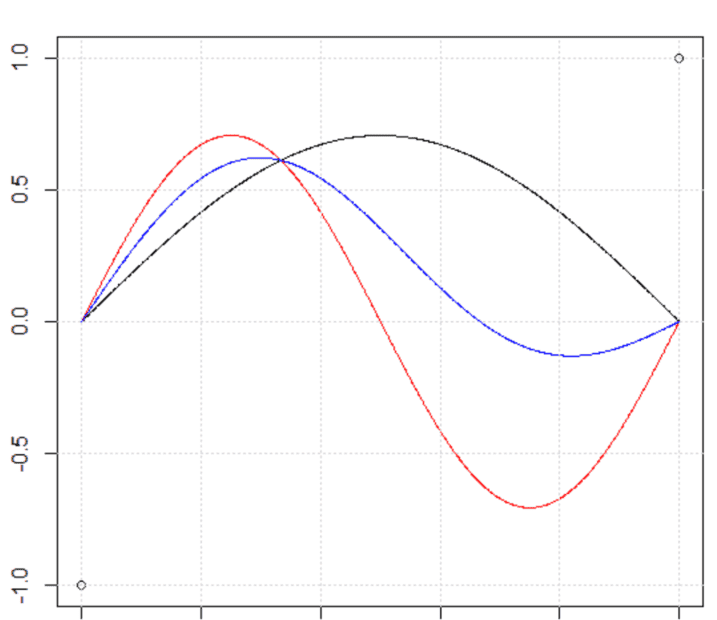

Put lines for y1 and y2 on the same graph. That should show you where you went wrong.
It should look like this, with black for y1, red for y2 and blue for the sum:
Plot of three curves over one period on a grid: a black sinusoid-like curve, a red curve with a larger swing, and a blue curve between them, all starting at the same point on the left axis and meeting again at the right edge.
By the way, did you notice your graph appears to have a period of 2 (ie it restarts the pattern at x=2) whereas it looks from your horizontal scale that you expected it to have a period of pi? That may also help locate the error.

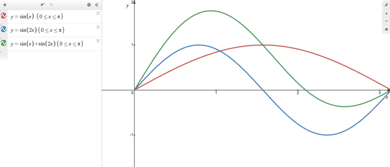

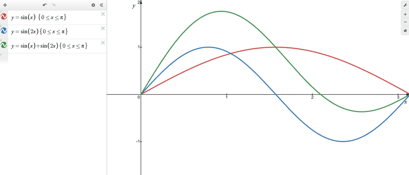

To be more specific on what I meant by the connection involved, I was assuming that there's
some sort of way to algebraically find ##L=\pi##, such that the only variable left in the sine argument is ##x##.
When that's plotted, it lines up pretty nicely with what I shared as the provided answer:
Graph of y = sin(x), y = sin(2x) and y = sin(x) + sin(2x) for 0 ≤ x ≤ π, with the sum curve in green peaking near 1.9 and the two component curves in red and blue.
But maybe there's no way to do that with the limited amount of information we have.
I guess my question is this:
Instead of breaking down ##k_1## and ##k_2## into the ratios I provided, are we supposed to
just recognize that ##k_2 = 2k_1## and just say that, for graphing purposes, ##k_1 = 1##?
Then ##k_2 =2## , and we get the expected functions of ##sin(x)## & ##sin(2x)##?
My apologies if that sounds confusing. Just making sure I'm understanding correctly.
  • Graph of y = sin(x), y = sin(2x) and y = sin(x) + sin(2x) for 0 ≤ x ≤ π, showing the red, blue and green curves plotted against x with y ranging from -1 to 2.
First of all, you will never be able to show that ##L=\pi## because ##L## has units of length and ##\pi## is a dimensionless number. Look at ##y_1=\sin(k_1x)##. The argument of the sine must be dimensionless so ##k_1## must have units of inverse length.
Note that when ##k_1 =\frac{2\pi}{L}##, when ##x=L##, the wave goes through one complete cycle. This means that the quantity that you call ##L## is nothing other than the wavelength ##\lambda.##
That would work. The important item to note is that the argument of one sine is twice that of the other. You need to plot two sines whose arguments have that relation. If you multiply both arguments by the same number and replot, you will have two plots that look identical except that the horizontal axis will be labeled differently.

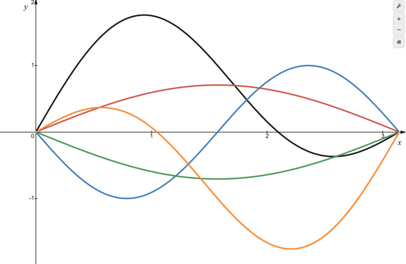

Here's the combined picture of all the waves in part (c), which I think helps visualize the correct answer to (d):
Graph of five curves of y against x from 0 to about 3.1, showing superposed waves at different times; the black curve peaks near 1.8 and the orange curve dips near -1.7.
The black line is for ##t=0##, the red for ##t=\frac {1}{8f_1}##, the blue for ##t = \frac {1}{4f_1}##,
the green for ##t=\frac {3}{8f_1}##, and the yellow for ##t=\frac {1}{2f_1}##.
These wave functions all match what's in my solution manual, so I think it's all good there.
According to my textbook, a standing wave is one in which the nodes remain stationary.
Clearly, that isn't the case here, since the nodes change in location as time progresses.
