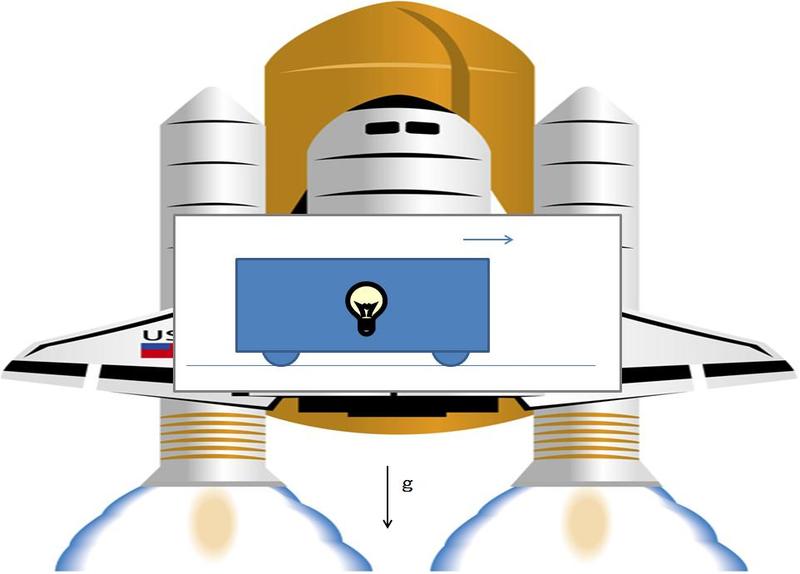

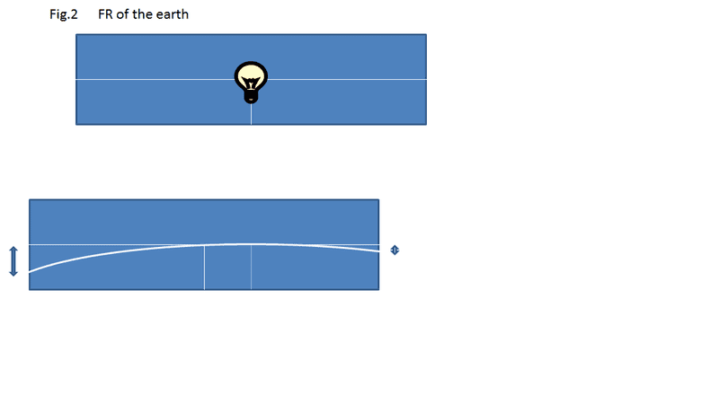

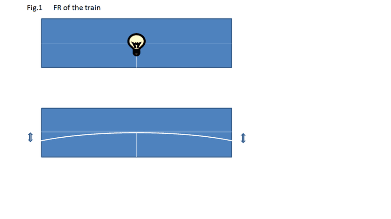

The discussion revolves around the effects of gravity on a thought experiment involving a train moving at relativistic speeds on a flat planet, as analyzed through the lens of special relativity and the equivalence principle. Participants explore how light behaves within the train under the influence of gravity, the implications for reference frames, and the nature of gravitational effects experienced by passengers.
  • Some participants propose a "stationary preferred" view where light is observed to fall with acceleration g by a stationary observer, leading to different heights at which light hits the walls of the train.
  • Others argue for a "passenger preferred" perspective, suggesting that light hits the walls at nearly the same height, but this view is contested.
  • Questions are raised about whether gravity creates a preferred reference frame and if this relates to the Lens-Thirring effect.
  • There is uncertainty regarding whether a passenger dropping an object would observe it falling with acceleration g as viewed by a stationary observer, with some suggesting that the weight experienced by passengers may increase by a factor of gamma.
  • Participants discuss the trajectory of dropped objects, noting that they would not fall perfectly vertically and may exceed the speed of light from a stationary observer's perspective.
  • Concerns are expressed about the application of the equivalence principle, particularly regarding the direction of acceleration relative to gravitational fields.
  • Some participants question whether the value of g remains the same across different reference frames, considering relativistic effects on the perceived density of a planet.
Participants express multiple competing views on the behavior of light and gravity in the context of the train experiment, with no consensus reached on the correctness of the "stationary preferred" versus "passenger preferred" perspectives. The discussion remains unresolved regarding the implications of relativistic speeds on gravitational effects and reference frames.
Participants note limitations in their understanding of the equivalence principle and the complexities involved in analyzing the effects of gravity and acceleration in different frames of reference. There are unresolved mathematical steps and assumptions regarding the behavior of light and objects in the train.

Indeed this feels like a not-so-gentle introduction to GR, but it's great to witness a real problem being solved, so I'm grateful for that. Hopefully I'll eventually understand all the steps.
But perhaps, as a sanity check, could we go back to I or B level for a bit? I was thinking about this scenario:
The passengers drop another marble out of the train (or just out of the rocket if that's simpler) and point a laser beam at it. In which direction do they need to aim?
It seems that if the train rotates, they'd eventually have to point upwards? Or does the rotation get slower over time?
Peter's transformation seems OK in this experiment, however checking if his metric is consistent with the transformation is well beyond my skill.
