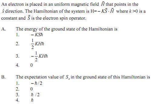

shally
Kindly take a look at the attachment for the problem statement.
Schrödinger Equation: H psi = E psi
For Part A: H psi = E psi
S= 1/2
So energy of ground state is -1/2.K.H.hcross
Could you tell me if I am on the right track?
I have no idea on how to attempt Part B. Kindly help. Thank you.
S= 1/2
Yes, that's correct.
Since the magnetic field has no component in the y or z directions, the Hamiltonian just extracts the x component of the spin and multiplies it by -KH. So eigenvectors of the Hamiltonian are eigenvectors of Sx.
However, you're looking for the expectation value of Sz. Can you write the ground state in terms of the spin states for the z direction?
