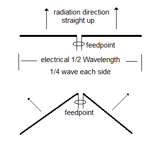

Is that a quarter wave per leg or total? A 1/2 wave vee has a pattern nearly identical to a dipole. On the third harmonic, you'll have additional major lobes.

Ah yes, I am terribly sorry, each leg of the V is a quarter wave monopole. I did the math for a quarter wave mono pole and then summed the energy terms. I will have to check out 4NEC2.
Dave I am terribly sorry I have not answered your questions adequately, I am just learning this material, we have not got to ground effects or anything fancy yet. We derived the EM wave equation, solved it then started applying that to simple antennas in free space.
So yes this would be a V shaped antenna in free space with a total of a half wave (quarter wave for each leg), I just want to make sure my radiation patter looks correct in my post #5 attachment.

OK so now that we have established that this is a 1/2 wave dipole
Confirm that the feedpoint is in the centre
and if so, then the comment Berkeman made in post # 3 is applicable
do some googling with his key words
Us amateurs ( ham radio guys) Berkeman, myself and prob. a few others on here use inverted V antennas mainly on the HF bands 1.8 - 30MHz
just for a little practical antenna use
top diagram a horizontal dipole ... radiation directions straight up, down, in and out of page ... nothing off the ends
this is not ideal, as it makes the dipole very directional, also a lot of the signal is radiated straight up bounces of the ionosphere
and comes straight back down ... waste of energy ;)
using an inverted V lowers the overall radiation pattern by lowering the angle and making better use of the ionospheric reflection
it also improves the antennas performance by making it less directional
I appreciate this doesn't directly answer your MATLAB queries. Just giving you some practical use

Thank you dave, we got it sorted out in class today. I made some really dumb errors when I summed the 2 mono poles. I should have summed the theta hat and phi hat of each mono pole taken the conjugate and then added them but I did it backwards. Also I had to take the absolute value because there were residual imaginary components. Now on to the loop antenna.
I believe my aircraft radio antenna is a V dipole and that VOR stations are hertzian dipoles. I am excited to get to fractal antennas and scattering. Fractal antennas were invented by a ham radio operator whos condo association would not let him have big antennas on his back deck area, pretty clever. He made it out of coat hangar. Have you tried spiral, fractal or loop antennas?
I would imagine for a ham radio you would not want it highly directional, the radiation pattern I got in class was really bloby for a V antenna and yes the feed was from the middle but I could modify each length and model the pattern if I wanted too.
