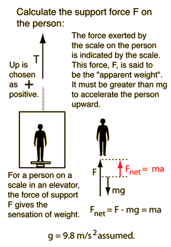

First of all, i don't understand how the reading on the scale can vary under their weight if the elevator is going up. It seems to me that unless the acceleration is negative, their weight should be positive throughout going up. Where is my logic wrong?
For a mass m= kg, the elevator must support its weight = mg =Newtons to hold it up at rest. If the acceleration is a=m/s² then a net force=Newtons is required to accelerate the mass. This requires a support force of F=Newtons. Note that the support force is equal to the weight only if the acceleration is zero, and that if the acceleration is negative (downward), the support force is less than the weight. If you enter a downward acceleration greater than 9.8 m/s² you will get a negative support force, showing that you must force it downward to get an acceleration greater than that of free fall.
