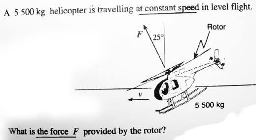

What is the force in the y-direction given the force and angle?

for the second i know that the total of the forces must be 0 because there's no acceleration. i know (or think) that the y-component of F is 53900 N but i can't figure out how to get the x-component because there's no acceleration. so for this i just want to know how to get the x-component.

And for the second one I drew a free body diagram but the only forces I can think of is F and the force of gravity. And I can't figure out how to find the x-component of F... shouldn't it be 0 since there's no acceleration? But there can't not be acceleration since the helicopter is moving... are there any other forces in the x-direction?
Good.
The fact that the helicopter is in level flight tells you something about the sum of the forces in the y-axis.
The fact that you're given the angle between the force of the rotor and the vertical means the remainder of the problem is simply plugging values into equations.

And in the second question, I've got the y-axis forces but how do I get the x-axis forces?
If you got the y-axis forces, you must have used a trig function to find the y-component of the rotor force. Use another trig function to find the x-component.
So in that case shouldn't the tension pulling on the block be mgsin32? But if I use that I still don't get the right answer..
And in the second one shouldn't the forces on the y-axis just be the weight and the y-component of the force, which is equal to the wieght?
The mass is in static equilibrium, so all component forces to the left must equal those to the right, and all component forces down must equal those going up.
Since the only x-components are the friction force, the tension of the horizontal string, and the x-component of the string to the wall, you need to balance them. Remember that the block is not moving. What does that tell you about the relationship of its x-component forces?
Once you figure out the tension of the string to the wall, figure out its y-component. That y-component must balance the weight of the mass in order to keep it in static equilibrium.

joess said:
And by second one I meant the second question.
Then yes, your statement was correct. And since acceleration is also zero in the x-direction, the statement also applies that way (once you apply the correct forces).

So for the second question I still can't figure out how to get the x-direction forces. Is the x-component of the rotor's force the only x-axis force?
I just re-read the second question; you don't need the x-component. All you need is the force itself.
If [tex]F_{y} = F \cos(\theta)[/tex], solve for F.
(Sorry if my direction misled you.)
