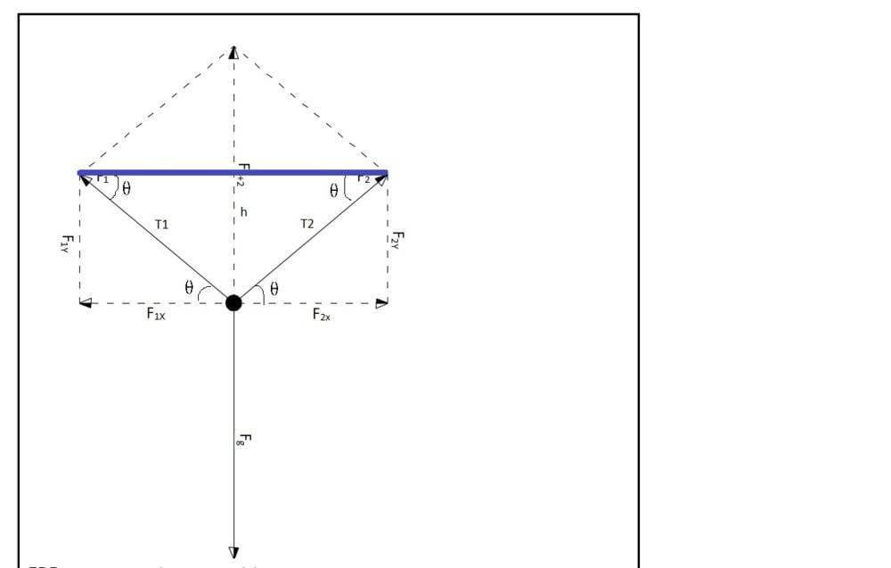

A few errors there.MrNewton said:Height = √(Lspring2-302)
Mg = m*g
k = (m*g)-(Lstretched-Lrest)
Vertical force balance equation: Fg = F1+2 Sum of forces in Y direction is 0 @ equilibrium(not sure if this is what you mean)
I defined L as the unstretched length, so use that, no numbers!
So the stretched length is √(L2+h2)
So how much is the extension? What is the tension? What is the vertical component of the tension?

But h is unknown? In know h of 1 spring in vertical component is 9,81 m/s2 because total vertical component is 19,62 but i cannot use this to calculate the length of the stretched spring can i? Since thet have different unitsharuspex said:So how much is the extension? What is the tension? What is the vertical component of the tension?

That's why we write equations containing unknowns, so that we can find out what they are. Just follow the steps in post #32. Don't worry for now about which are known and which unknown.MrNewton said:But h is unknown?

haruspex said:That's why we write equations containing unknowns, so that we can find out what they are. Just follow the steps in post #32. Don't worry for now about which are known and which unknown.
Alright:
Extension = Stretched length - Length @ rest
Tension = -k * Extention
Vertical component of tension = SIN(theta)*Tension OR √(Heigth2+length@rest2)
With Theta i mean the angle between the spring and the ceiling.

Nearly right. You missed a term in the expression for sin(θ) after OR, and there's another equation relating stretched length to other lengths.MrNewton said:Alright:

Seems to be some confusion between forces and distances.MrNewton said:So here are my equations for this diagram:
Fg = m*g
T1 = √(F1y2+F1x2)
T2 = √(F2y2+F2x2)
Height from mass to ceiling = Sin(theta)*T2
T1x = √(T1SUP]2[/SUP]-T1y2)
T1y = √(T1SUP]2[/SUP]-T1x2)
STILL TYPING...

Check your equations -- first 3 are ok, number 4 has a length on the left and a force on the right
last 2 have typos and I suspect one sign error
And: take a rest, count to 10, breathe in, out, in.. etc. etc.
You're doing fine and are getting pretty darn close too

Some - perhaps useful - comments:
You have T and F but: what's the difference ?
What happened to ##|\vec T_i | = k (L_i - L_{i, 0})\ ## ?
You use one ##\theta##, but as soon as the mass is off zero on the x-axis, there will be two different ones
remember: you are going to integrate the equations of motion ##\vec F = m\vec a ## so you will need a ##\vec F(x, y)## .

You are referring to my post #37 with this comment?
This formula. Well this is exactly a problem I am dealing with. How do i calculate this? Since i want to know a distance, but i only know a force and an angle. I should calculate the length of the spring with Hooke's law? And if i know the distance of the spring i can calculate the height?By typos you mean the [SU.B] ? They have been fixed

You are referring to my post #37 with this comment? ##\qquad## yes
Height from mass to ceiling = Sin(theta)*T2 ##\qquad## No. ##L_2 \sin\theta_2## (which happens to be equal to ##L_1 \sin\theta_1## -- so there you have an equation too ! )
They have been fixed ##\qquad## Good. Still think you'd better keep to either F or T, not both.
If at equilibrium the mass is at position (0,0), can you develop a function ## \vec F (x,y)## ?

BvU said:Height from mass to ceiling = Sin(theta)*T2 \qquad No. L2sinθ2L2sinθ2L_2 \sin\theta_2 (which happens to be equal to L1sinθ1L1sinθ1L_1 \sin\theta_1 -- so there you have an equation too ! )
Or i can use tan(theta) = h/l
h = tan(theta)*l (they are both lengths)?
//(l = relaxed spring)
Not sure what the ## means?BvU said:##\vec F(x, y)## ?

Not yet. re-read the various commentsMrNewton said:I think i can. Does this mean i got the equations right?
Make things explicit: parameters (like ##L_0##) , variables like ##L_1, L_2, \theta_1, \theta_2## that you want to express in relationships with ##x## and ##y## until you have as many equations as you have unknowns -- otherwise the problem is unsolvable (and yours is not unsolvable)
Certainly not ! There is no information re Force, except 'krachtstoot', i.e. impulse. I hate to give away too much, so all I can say is: modelling a force from the left is not in order. All you are given is the input of a small whackShould i inplement the sharp force from the left already? By that i mean make F1x 100 Newton for example?
for which you may assume some value (and will need to for a numerical simulation). For now, all you need is a symbol. Think 'what does this mean for the simulation ?'.

Alright, i have written al the possible equations for θ1, θ2, L1, L2.
θ1:
SIN(h/L1)θ2:
SIN(h/L2)h:
SIN(θ1) * L1
SIN(θ2) * L2
L1:
h/SIN(θ1)
L2:
h/SIN(θ2)
Homework Helper
- 16,222
- 4,937
If the mass moves 1 unit of length in the +x direction, what is the change in ##L_1## ? And in ##L_2## ? This has consequences for ##F_1, F_{1,x}, F_{1,y}, \theta_1, F_2, F_{2,x}, F_{2,y}, F_{tot, x}, F_{tot, y}, \theta_2 ## so also for ##a_x, a_y##
[edit] and ##\sin\theta_1 = h/L_1 \quad \Rightarrow \quad \theta_1 = \arcsin (h/L_1) ##, etc !

The simulation you are setting up will integrate the equations of motion, ##\vec {\bf a} = \vec {\bf F} / m##
At ##t_0 = 0## you have $$ x_0 = 0, \\ y_0= 0, \\ v_{x,0} = ..., \\ v_{y,0} = ... , \\ a_{x,0} = 0, \\ a_{y,0} = 0
$$With the simplest integrator, forward Euler, you can calculate the situation
at t = ##t_0 + \Delta t ##:$$ x = x_0 + v_{x_0} \Delta t , \\ y = y_0 + v_{y,0} \Delta t, \\ v_{x} = v_{x_0} + a_{x,0} \Delta t \\
v_{y} = v_{y_0} + a_{y,0} \Delta t
$$ and then you need to calculate a new ##\vec {\bf a} ## at position ##\left (x(\Delta_t), y(\Delta_t) \right ) ##
and so on.

Thanks for those equations. THIS ONE, : X = X0 + V0 * ΔT, Shouldtn it be, Xn = Xn-1 + Vn * ΔT ?
With n the current timestep
So the current speed instead of the previous speed?
and for the acceleration:, an+1 = Fn+1/m

The starting point is the position and velocity, ##\vec r_0##, ##\dot{\vec r}_0##.MrNewton said:Thanks for those equations. THIS ONE, : X = X0 + V0 * ΔT, Shouldtn it be, Xn = Xn-1 + Vn * ΔT ?
From these you calculate an acceleration, ##\ddot {\vec r}_0##.
For the next timestep, ##\dot {\vec r}_1=\dot{\vec r}_0+\ddot {\vec r}_0\Delta t##.
So for calculating ##\vec r_1## you have two velocities available. Taking the average should work well.
