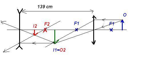

silvercrow said:
Wait i was taking focal length as negative :P . I started this chappter two days ago ... but the ray is not reaching the concave lens so why consider it ?
The ray reaches the second lens if it is big enough. Or draw those rays which reach it :)
The focal length of the converging lense is positive, that of the diverging lens is negative.
The second image is virtual: It forms in front of the second lens. You have to draw the rays backwards to get the intersection.

Your ray diagram seems tovbe wrong because according to convention rays are drawn left to right :)
He-he. In my country,they can go in any direction, (the arrows show the direction); moreover we use the lens formula 1/t+1/k =1/f and define magnification as N=k/t and it is positive when the image is inverted.:biggrin:
