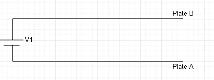

An electron is released with zero initial velocity from the lower of a pair of horizontal plates which are 3cm apart. The accelerating potential between these plates increases from zero linearly with time at the rate of 10V/uS. When the electron is 2.8cm from the bottom plate, a reverse voltage of 50V replaces the linearly rising voltage.
a, What is the instantaneous potential between the plates at the time of the potential reversal?
b, With which electrode does the electron collide?
c, What is the time of flight?
d, What is the impact velocity of the electron?

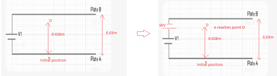

Let me do it from beginning, the variables are
##m_e -> 9.1*10^{-31}kg, ## ##q_e -> 1.6*10^{-19}C, ##
##\alpha -> 10^7 V/s, ##
##d_t -> 0.03m (distance between plates),##
## a->acceleration, m/s^2##
##v-> velocity, m/s ##

b. To find if the electron reaches point "B", check if the velocity of electron at the time it reaches plate "B" is positive.
Energy at point D = Energy at Plate B;
##KE_d + PE_d = KE_b + PE_b ##
##PE_d = q_e*1.47V ## derived for part a
##PE_b ## = 0V
##KE_d = 0.5mv_d^2##
##KE_b = ?##
##KE_b = 0.5mv_d^2 - q_eV_d##
##V_d=1.47V## derived from eq4. Substituting the values
##KE_b = 1.8*10^{-19} J##
##PE_b = 2.35*10^{-19} J ##
Since the ##PE_b## is greater than ##KE_b## the electron does not hit the plate B.

You are on the right track. But the electric field is not 50/0.002 Between what positions is the 50V is being applied??
Not sure if i am correct. The potential at point D from post #5 is ##V_d = 1.47 V## and ##V_b = 50 V##, ##V_{bd} = 48.53V##. Hence ##E = \frac {48.53} {0.002} = 24265 V/m##. Am i correct?
No. The electric field between the plates is constant. It has magnitude given by ##E=\frac{V}{d}## where ##d## is the separation between plates. After the reversal, the direction of the electric field is from high to low potential, here from A to B. The expression for the potential is ##V=Ex+V_0## where ## V_0## is a constant chosen to be the potential at ##x=0##. Here you can pick ##V_0=0##. The potential is not as relevant as the acceleration for answering parts (c) and (d). Since you need the time of flight and the impact velocity, you can get both using the appropriate kinematic equations.
I repeat my exhortation to use symbols instead of numbers. It will make our job of helping you much, much, much easier and is in the interests of all involved.
Not correct. In your original question you are told:
"When the electron is 2.8cm from the bottom plate, a reverse voltage of 50V replaces the linearly rising voltage. "
EDIT: Note the use of the word 'replace'. The original rising voltage has gone!
If you wanted to measure the 50V, where would you connect the voltmeter?

Ok, now i understand the question clearly. The E field is ##E = \frac{V} {d} = \frac{50} {0.03} = 1.66KV##

I guess you are taking the +x direction to be plate A to plate B. The 'reverse voltage' (50V) causes an acceleration in the -x direction. So you should have a negative value for acceleration if you are applying the kinematics equations consistently.
Now it is more confusion. The sequence of steps i followed
Step1: When accelerating potential is applied till 0.028m, i used the Equation 1 in post #5 to calculate the velocity ##v_d##.
Step2: When the electron reaches the 0.028m, the reverse voltage is applied, kinematic equation is used in post #14, since the electron has another ##0.03 - 0.028 = 0.002 m## to travel if it has to hit the plate "B" and constant reverse acceleration is applied. So, i used the initial velocity of ##v_d## and it is decelerating and i am finding the distance it can travel. What is the mistake?
What units are used for electric field? What is the difference between 'k' and 'K' in the context of units?
I am not sure how i am missing writing the units. Sorry the unit of Electric field is kV/m basically i should have written ##E = -1.66*10^3 V/m ##
The original kinematic equation is ## v_f^2 = v_i^2 + 2ad; v_f=v_b = 0, v_i =v_d ##
##v_b^2 = v_d^2 - 2ax; v_d= 6.3*10^5 m/s##
##a = -\frac{qV} {md} ; V=-50 V, d=0.03 m##
## a = -2.93*10^{14} m/s^2##
##0 = 3.9*10^{11}-2*2.93*10^{14}*x##
##x = 6.65*10^{-4} m##

There is no mistake. I got confused with all the numbers and what they mean. Please see post #15. I think you are good to move on to parts (c) and (d).
I agree with kuruman - I think you are correct so far (but your working is difficult to check/follow).
