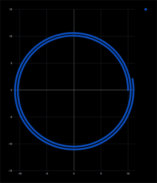

I think @haruspex is right. We can calculate the rate at which the radiation pressure increases the total mechanical energy of the ship for a given orientation of the sail. But, in my solution, I assumed the orbit would remain approximately circular. I imagined an orbit that slightly spirals outward when the sail is active. So I took ##E = -\large \frac {GMm}{2r(t)}## as being a good approximation for the energy ##E## of the ship at time ##t##, at least for small ##t##. But, that could be a bad assumption. I won't have much time to think about this over the next few days.
More thoughts…
Consider the case where the sail is always pointed at the Sun. The satellite starts in a circular orbit at radius R then unfurls the sail.
Since the force on the sail is radial and inversely proportional to the square of the orbital radius, it is like a reduction in G, to G' say. The new trajectory is therefore an ellipse.
Since there is no instantaneous change in position or velocity, the trajectory will return to that initial state, and since in that state the velocity is normal to the radius that point will be the apogee.
The angular momentum remains at ##mvR=m\sqrt{GMR}##. That makes the perigee ##R\frac{G}{2G'-G}##.
Note that at ##2G'=G## the satellite escapes.
haruspex said:
Is it not the case that a steady radially outward force would result in an orbit with reduced perihelion, no matter for how long it is applied?
You'd subsequently posted a nice and pithy analysis for a purely radially outward force. When a radially outward inverse ##r^2## force is suddenly turned on, the effect on the orbital path is that the current velocity is suddenly too large for the pre-existing circular orbit. The new central net force is still inverse ##r^2##, so the new orbit will be an ellipse and will have its perihelion at the original orbital radius.
With a canted sail, the same logic applies. The new orbital path will be approximately elliptical but will spiral outward from that baseline at a rate that depends on the tangential component of the net force. One might try to circularize the new orbit by modulating the tangential thrust, though there seems little point in doing so.

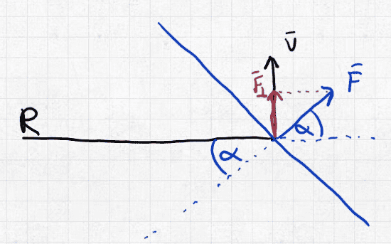

With canted at an angle sail I have:
Hand-drawn diagram of a tilted flat sail: a blue slanted line with a vertex, a horizontal reference line labelled R, velocity v pointing up, force F at angle alpha, and its tangential component F_t in red.
The formula for F:
$$F = F_{0} \cdot cos^2(\alpha),$$
tangential component:
$$F_{t} = F_{0} \cdot cos^2(\alpha) \cdot sin(\alpha)$$
Now I find for what ##\alpha## the ##cos^2(\alpha) \cdot sin(\alpha)## is maximum then calculate the rate of potential energy change?
The formula for F:
I came up with a different formula following a different line of reasoning and used the angle of the sail rather than the angle of its normal. But I suspect that both yield the same result and that both optimize at the same angle.
Yes, after a little behind the scenes work, both come out the same.
[I used the sine of the angle of the reflected ray (twice my alpha) to get its tangential momentum component and the sine of the angle of the mirror to get the cross section. After some trig and double angle formula evaluation, that comes to ##2 \sin^2 \alpha \cos \alpha##. The factor of two comes out of the computation of ##F_{0}##. Mine is not doubled. The ##\sin## versus ##\cos## swap comes from the choice of using sail angle rather than sail normal angle].
You can make the substitution of ##1-\sin^2 \alpha## for ##\cos^2 \alpha##. That will give you a simple polynomial in ##\sin \alpha##. You can optimize that (solve for a zero first derivative) and then take the arc sine of the result. Then plug that angle into your formula for tangential force.
You will want to solve for ##F_0## either using the figures from the solar sail article or from first principles using ##E=pc##.

Why do you ignore the radial component, ##\cos^3(\alpha)##?

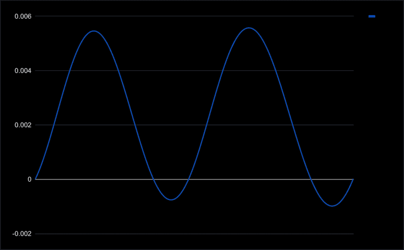

The instantaneous power delivered to the ship depends only on the component of the force parallel to the velocity. Initially, the velocity has no radial component.
But the question asks for the rate of gain of orbital radius. Increased tangential speed only leads to that indirectly. Radial acceleration leads to it slightly less indirectly.
Specifically, if in a circular orbit at radius R speed v and subjected to acceleration ##a_r\hat r+a_{\theta}\hat\theta## then after time dt the radius has increased by ##\frac{v}{2R}a_{\theta}dt^3+a_{r}(\frac 12dt^2+O(dt^3))##.
The question as posed cannot be answered. No matter how you angle the sail there is no instantaneous creation of nonzero radial velocity. It only makes sense as an average rate of gain over some preset increase in radius, or perhaps as an asymptotic value.
As you have analyzed yourself, the radial component leads to an immediate radial acceleration and a periodic radial velocity. Which is not what is being asked for.

I produced this plot in a spreadsheet.
Scatter plot of a spiral-like orbit in the x-y plane, drawn as blue dots on a black background with axes from -15 to 15; the path is nearly circular with radius about 10 and a small outward offset near the positive x-axis.
GM=1
R=10
F/m (force of radiation per unit mass at distance 1 from Sun when sail square-on)=0.01
dt=0.7
Rate of increase of radius maximises with sail tilted at around 0.617 radians (zero tilt meaning square-on), at which angle it averages 0.0023 in whatever units.
However, the rate of increase of r is sinusoidal, going negative occasionally. The time period I ran it for (about 600 time steps) showed two complete cycles.
Line graph of a blue sinusoidal curve against a horizontal zero line, with y-axis labels 0.006, 0.004, 0.002, 0, and -0.002; the curve has two peaks near 0.0055 and two troughs, one dipping below zero.
