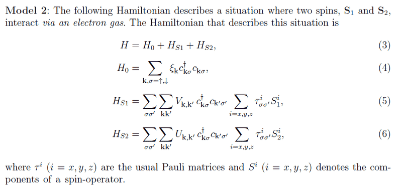

For an exercise I am given the attached Hamiltonian, but I don't understand it completely. We sum over spin -½ and ½ and the paulimatrices seem to be dependent on this since they are labeled by σσ'. What does this mean? I mean the pauli matrices are just operators for the spin in the x,y,z-direction, so what does it exactly have to do with our summation of spin eigenvalues.

hi aaaa202! :smile:
aaaa202 said:
… We sum over spin -½ and ½ and the paulimatrices seem to be dependent on this since they are labeled by σσ'. What does this mean? I mean the pauli matrices are just operators for the spin in the x,y,z-direction, so what does it exactly have to do with our summation of spin eigenvalues.
i'm not sure what you're asking
each pauli matrix, here written as τ1 τ2 and τ3, is a 2x2 matrix, so it has four entries, labelled ½½ ½-½ -½½ and -½-½
each entry of τi is written τiσσ'
So in each component the spin operator S=(Sx,Sy,Sz) I add the entries of the corresponding pauli matrix?
i don't understand :confused:
you add over every index (k k' σ and σ') in every ∑
(x y and z are not relevant indices for the spinors: those are ½ and -½)
Okay I misunderstood. I understand now - thanks :)
