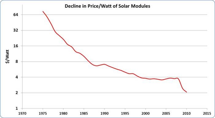

Solar might be better than you are estimating. It was a year ago that news reports told us that HALF of German electricity was coming from solar power. As the higher capacity has grown, a lot from government incentivized demand, the economics of solar panels have gotten much better. With economies of scale, and better processes, solar panels are not that uneconomical. I think they are under 150% the cost of coal power electricity.
When I've looked at rooftop solar panels, they definitely pay for themselves in my sunny spot in Utah. But the lifetime used is generally 20 years. I believe that they are warrantied to be at 80% of the original capacity at 20 years.
The cost per watt keeps dropping on panels. My understanding is that a very large part of that is simply economies of scale as the factory infrastructure is built and operated at higher capacity. I don't think there is much further to drop, but the cost is fairly competitive now. A lot of the cost side has yet to be fully worked thru, as maintenance and true lifetime power curves are still changing.

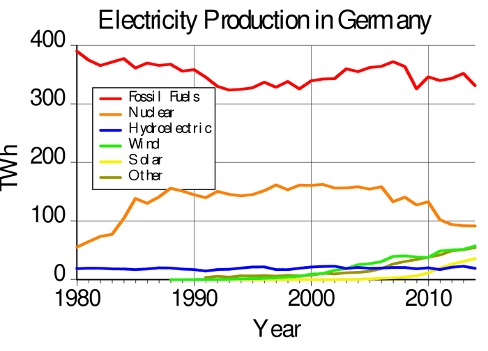

You misread. Coal is more than half of Germany's electricity production and like pretty much everywhere else, solar is an insignificant source of energy.

I think the news reports I read look like a snapshot, and it was misleading. They met half of demand with solar, but it was a low demand time. It is a bit difficult (apples to oranges) to compare power plant maximum capacities and what is being run. My impression is that Germany has been the leading installer of solar capacity, and once installed, Solar is used at full capacity available, and other plants are idled.
The yellow line for solar does show the story of increased installation. And you absolutely have to build capacity for peak demand, and the coal/nuclear plants will remain the main backstop for that peak. It looks like for the last decade, the only significant capacity they are adding is in Wind, Solar, and Other (hydroelectric?). The German goal is 80% of electricity from renewable sources. It may be that they will have a surplus coal plant capacity remaining idle.
I would say the electricity from solar in Germany is NOT insignificant. If you look at power capacity, it is still a very small fraction of the installed power production infrastructure. But it is used at 100% capacity available, which actually makes it more significant than you might otherwise expect.
The economics are definitely improved though. If given a purely economic choice between building a coal plant with 100 MW capacity, or solar installations at 100 MW capacity, the coal wins the business decision. But the gap has been getting smaller, as solar panel manufacture has moved to higher capacity, and has advanced technologically. THis curve shows some of the staggering progress in manufacturing costs of PV modules. And I think the drop has continue, and is now closer to $1 per Watt. Still higher than coal and natural gas, but surprisingly close.

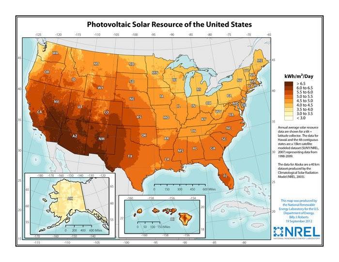

Being generous
solar insolation might be 5 kwh/day.meter^2
http://www.nrel.gov/gis/images/eere_pv/national_photovoltaic_2012-01.jpg
5kwh is 17,060 BTU's
which is the heat co10 ntent of 1.7 pounds of coal - about one sockful.
A coal plant might be 40% efficient ,
and a solar cell 10 % efficient?
So, to make 5kwh a day takes 50 ten square meters of solar cell (a twenty-three ten foot square array, size of a two car garage roof)
or 4¼ pounds of coal, maybe one shovel full.Next time you have to wait at a railroad crossing for a coal train, think about it. Just to heat the water for 100 million morning showers is over a quarter mile of coal cars.

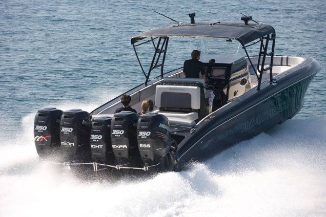

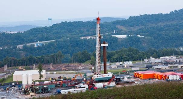

Look what we've done to the humble fishing skiff..
Gonna be some societal changes as we adapt to limited energy.
  • #44
Strapping several outboards together like that (above pic) is I think likely to be very fuel inefficient.
Each propeller will have below optimum water flow over the blades due to interference of the flow caused by the adjacent propeller(s)
Maybe two spaced well apart might be good, but five?

Conspicuous consumption, that...

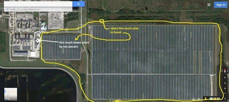

This plant uses solar collectors to preheat feedwater for its steam boiler saving around 10% fuel in good daylight..
The advantage is this plant still makes power at night, just a little less of it.
The aerial photo shows the convenience of fossil fuel. All that solar for 10% ?
If that's the http://www.energydigital.com/renewables/2926/Worlds-First-Hybrid-Natural-Gas-Solar-Power-Plant-Premiers-in-Florida, the solar attachment supposedly will save http://weblogs.sun-sentinel.com/business/realestate/housekeys/blog/2011/01/fpls_estimates_on_solar_costs.html in fuel costs(30 yrs), and reduce emissions a bit. With regards to the gas share of infrastructure for the plant there's a lot we don't see in the photo (which solar doesn't need), including some hundreds of miles of gas pipeline, gas storage, and of course several of these below for just the one plant (I calculate 1882 - 100 Mcf/day gas wells for one 1150 MW plant @50% eff):
"All that solar" just refers to some space taken up by the collectors. Show us the whole coal story: the pile of coal, the coal mines, the truck that haul it, the men that dig it, all that.
  • #49
zoobyshoe said:
show us the whole coal story: the pile of coal, the coal mines, the truck that haul it, the men that dig it, all that.
well, in this case it'd be natural gas by pipeline.
  • #50
Same problem, though. There's a whole natural gas infrastructure that isn't being shown in that pic compared to "all that solar."
  • #51
quite so.
And solar doesn't replace that infrastructure or relieve its necessity if we're to have power outside the five hours per day of good sunshine.
  • #52
True, but 'solar doesn't work at night' is a different objection than "all that solar," by which you mean the large area required by solar collectors.
Fossil fuel is basically millions of years of stored solar energy, and there's no way we'll ever be able to compete with that once it's depleted. Eventually we'll have to collect solar directly as it hits the Earth as best we can. The more we do that now, the better we'll become at it and avoid a sharp, forced learning curve down the road.
  • #53
I'm not sure why you keep harping on land use efficiency. It seems irrelevant. We all see that the most compact power source is nuclear, and solar can only harvest a portion of the solar constant (IIRC about 1.3 watts per square meter). In an area where the solar surface area is high priced, don't buy that surface area as an economic proposition.
Costs need to be considered. If they bought an acre of what looks like rural/agricultural land, and put a solar array on it, then you have to account for that opportunity cost.
You keep presenting power compactness as the definitive reason that fossil fuels are superior and that just doesn't matter as much as you portray it. Fossil fuels are cheaper. THAT matters. If solar gets cheaper, THAT matters.
As was pointed out, that solar field vs the power plant also ignores the amount of surface area dedicated to strip mining, or fossil fuel collection. There might be another photo with the collected areas of the fossil fuel collection ... that might be larger than the field where the solar sits.
There are cost-benefit analysis with every electric generating process. I think the cheapest in the US right now is natural gas. We should use the heck out of that. Cheaper is great. But it is important to notice that the PV module supply has been growing, getting cheaper, and while producing more efficient panels. The largest part of that economic improvement has been a result of German government subsidies for installations, which drove market demand, which drove producer investment. It was one of those chicken-and-egg situations, industrial investment in panels needed demand, and demand needed lower prices, and lower prices needed industrial investment, and so on. There is still an open question as to what the eventual price will drop to. Demand is now growing in ordinary consumer markets ... as I said, I am considering a home installation for economic reasons.
In that home installation, I will put roof surface area, ordinarily acting as environmental isolation of the home interior, to a second use. The surface area is basically free. Other than I am waiting to time solar installation after a new roof installation, as my roof is about 19 years old ... the economics have to include not throwing away 10% of roof life.
I think costs have to be evaluated and benefits have to be evaluated. If surface area is important, then it has to be considered. I tend to think it is an unimportant part in most cases. The picture you show does not really tell us the value of the land they used. Maybe the installation was purely a show, maybe the installation was a well reasoned economic investment.

Utility scale i'd rank
1 Hydro, 2 Steam, followed by wind and solar where they're plentiful.
Homeowner scale i'd rank
1.Reduce consumption of electricity by direct solar heat collection for space and water heating, on premise not using electricity in the first place it is as good as making it..
2. Rooftop solar PV at latitudes where it makes sense, windmills where they make sense
If we're to keep our mechanized society and lifestyle i do not see the electric grid going away. Nuclear steam will replace fossil as carbon resources dwindle, buying a century or two to get fusion up and running.

mheslep said:
(I calculate 1882 - 100 Mcf/day gas wells for one 1150 MW plant @50% eff)...
Apparently ~7000 Mcf/day is more typical for a gas well brought online in the last few years, so 26 wells are enough for a 1150 MW plant at 50%.
