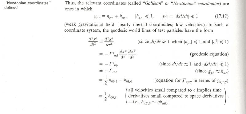

The way I read it, you can almost always get a limit where the approximate equations of motion of a particle are given by
[tex]\frac{d^2 x^i}{dt^2} = - \partial \Phi / \partial t[/tex]
over some region R. These coordinates will be called "Gallilean" or "Newtonian" coordinates. It seems that it's usually assumed that R extends out to infinity, one might want to add in some disclaimers if R is (as in our example) restricted to R_min < R < R_max.
Since you don't appear to have MTW, I've attached a short scan for how you approximate the equations of motion to arrive at this conclusion. (I think this scan is small enough to be covered by fair use as far as copyright goes).
Note that MTW uses a comma to indicate normal partial derivatives. A semicolon (not used here) would be a covariant partial derivative.
Now, what do you call it when you have Newtonian coordinates, but Phi is not of the Newtonian form -M/r^2? I'm not quite sure how to describe this situation, which is the one you're interested in.
MTW's proof demonstrates that [itex]\Phi = -h_{00}/2[/itex] with the possible addition of an arbitrary constant to the potential, which won't affect the equations of motion.

I have MTW. This is only half of the proof. The other half is the connection between Ricci(0,0), the matter density rho and the Christoffel in the geodesic equation which later is identified with the gradient of the potential. I already know all this. When they derive it, they first drop time derivatives of the metric because they consider a static case and second they drop any product of two Christoffels in Ricci(0,0) because each Christoffel is of first order in the metric perturbation when the unperturbed metric is Minkowski (for which the unperturbed Christoffels are all zero).That doesn't work when the background metric is de Sitter because its unperturbed Christoffels are not zero like Minkowski, and consequently the perturbed Christofells are NOT first order in the metric perturbation. That leads to extra terms in Ricci(0,0). Some of those terms create acceleration of the same order as the one created by the Lambda matter density in the final equation and it is inconsistent to drop them but leave Lambda.
MTW is not a good source for anything connected to Lambda because at those times they didn't know about 'Universe acceleration' and set Lambda = 0. Aside from that, even their Newtonian limit is not good cause they create the impression they do it for 'slowly moving' matter density when actually the Newtonian limit is for STATIC source. That is obvious from the final Newtonian equation - it describes INSTANTANEOUS force - if the matter density changes a little at one side, the gravitational potential responds instantaneously at some distant point which we know can't happen. So the derivation is for STATIC source not 'slowly moving' as MTW claim. It's not an accident that Sean Carroll and other textbooks explicitly talk about Newtonian limit for static source which initially puzzled me since MTW don't mention the word static at all.
