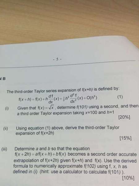

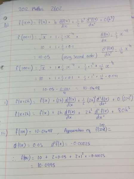

Hi could anyone give me pointer as to where to go with part iii please?

second order accurate means
$$\begin{cases}
A|_{h=0}=B|_{h=0}
\left. \dfrac{dA}{dh}\right|_{h=0}=\left. \dfrac{dB}{dh}\right|_{h=0}
\end{cases}$$
so require
$$\begin{cases}
\mathrm{f}(x+2h)|_{h=0}=a \, \mathrm{f}(x+h)+b \, \mathrm{f}(x)|_{h=0}
\left. \dfrac{d}{dh}\mathrm{f}(x+2h)\right|_{h=0}=\left. \dfrac{d}{dh}(a \, \mathrm{f}(x+h)+b \, \mathrm{f}(x))\right|_{h=0}
\end{cases}$$
then solve for a and b

did you find a and b?
Ok that's great thank you! I am going to attempt it now that I understand it! I'll place my answer on here afterwards, I gather you have found them then?
^I could not resist
I have found a as 1 is that correct? and using that value I get b as
b=((((hdf(x)/dx + 3/2*h^2*d2f(x)/dx))))/f(x)
Remember h=0 so it should not appear. Since we are second order we should not have h^2.
Here is another equivalent approach
$$\text{if}
\mathrm{f}(x+2h)=\mathrm{f}(x)+2h\, \dfrac{df}{dx}(x)+\mathrm{O}(x^2)
\mathrm{f}(x+h)=\mathrm{f}(x)+h\, \dfrac{df}{dx}(x)+\mathrm{O}(x^2)
\mathrm{f}(x+2h)=a\, \mathrm{f}(x+h)+b\, \mathrm{f}(x)
\text{then}
\mathrm{f}(x)+2h\, \dfrac{df}{dx}(x)+\mathrm{O}(x^2)=a\left[\mathrm{f}(x)+h\, \dfrac{df}{dx}(x)\right]+b\, \mathrm{f}(x)+\mathrm{O}(x^2)
\mathrm{f}(x)+2h\, \dfrac{df}{dx}(x)=a\left[\mathrm{f}(x)+h\, \dfrac{df}{dx}(x)\right]+b\, \mathrm{f}(x)$$
What do a and b need to be?
that makes so much more sense! as you say I included the h^2 accidentally so that must be where i went wrong, I'll try and solve it the original way again and see if I get the same answer!
From what I can see a needs to be 2 and b has to be -1
^Good job
