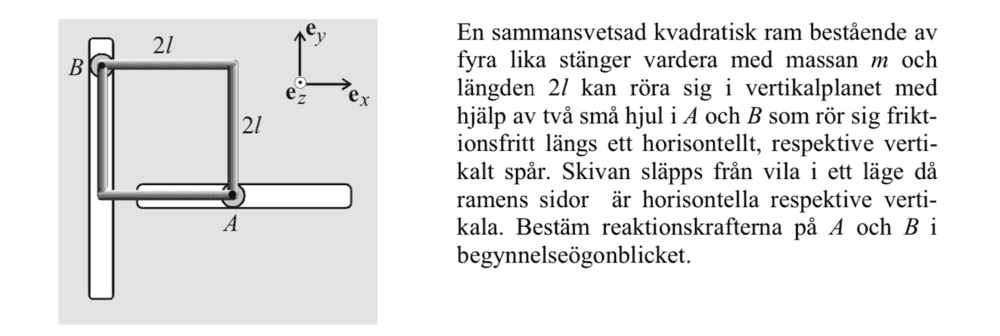

A welded square frame consisting of four equal rods each with mass m and length 2l can move in the vertical plane by means of two small wheels in A and B that move without friction along a horizontal and vertical track, respectively. The disc is released from rest in a position where the sides of the frame are horizontal and vertical respectively. Determine the normal forces in A and B at the beginning moment.
