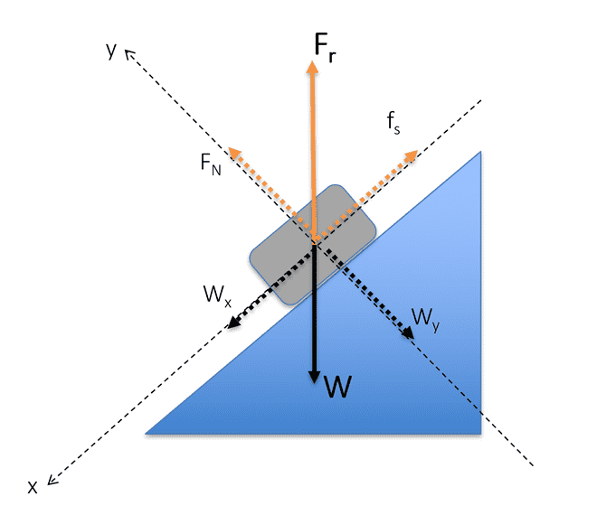

Hello,
When we consider a block sitting on a surface, the gravitational force ##W## and the normal force ##F_N## are applied to the block. Both equal i magnitude and opposite in direction. We call the normal force the reaction force exerted by the surface on the block.
Now we consider the block on an inclined plane. The block is not moving. Gravitational force ##W##, normal force ##F_N##, and static friction ##f_s## act on the block to produce static equilibrium.
Question: both the normal force and static friction are produced by the same entity, i.e. the surface. In general, by Newton's 3rd law, an entity (surface) produces a force on another entity (block) and vice versa, and not multiple forces...That said, when normal force and friction are both present, is it more correct to consider friction and normal force as the parallel and perpendicular components of the single reaction force ##F_r## or as two separate forces both generated by the surface itself? It feels more correct to interpret normal force and friction as components with the reaction force pointing at some non perpendicular angle to the surface.
Thank you!
You are not wrong in principle. However, the functional form of the normal and frictional components are different. So it also makes sense to treat them separately, as individual forces.
I agree with you and for other reasons that just in principle. A foolproof way to account for the forces acting on a system in a free body diagram (FBD) is to count all the entities outside the system that can exert a force on it. Then draw arrows representing the forces, as you have done. I would draw the FBD for the block at rest on the incline exactly as you have done, one "arrow" for the force exerted by the Earth and one equal and opposite arrow for the force exerted by the incline. I may have to resolve these vectors into components with respect to some convenient coordinate system in order to answer a question, but that's a whole 'nother issue. The fact remains that, to satisfy Newton, when the block is in equilibrium with only two pieces of the Universe acting on it, the arrows representing the two forces have equal magnitudes and opposite directions because that's the only way to add two vectors and get zero.
That said, it is useful to give names to frequently encountered components of forces in order to signify their direction. I differ from @Dale about treating them separately. We have directed components,
Normal = the component of the surface force that is perpendicular to the surface.
Friction = the component of the surface force that is parallel to the surface.
Centripetal = the component of any force that points towards the center of a circle described by the object.
Clearly, a friction force can also be centripetal as in the case of a car going around in a circle on level ground. Thinking of friction separately could be confusing to beginners who might ask "how can friction be centripetal?"
Finally, I commend you on your FBD drawn to scale.

Thank you everyone for the helpful comments.
What bothered me when I created the thread was:
  • A FBD included ALL the forces acting on the body of interest (aka the system). Each force is supposedly due to a specific single agent in the environment. The fact that there would be two forces both due to the surface of the inclined was a point of confusion for me (it seems to clash with Newton's 3rd law because the pair block/surface should have a pair of force but, in this other view, the block exerts a force on the surface and the surface exerts two forces on the block).
  • It flows better, for me at least, to view the normal force and the static friction (in my specific example) as the components of a single force, the reaction force of the surface.
  • I see Dale's point that normal force and static friction are obtained using very different equations.
  • I agree that a force and its components are the same thing. But the components are coordinate system dependent while the FBD is coordinate system independent.
  • All physics books would have the normal force and the static friction as separate vector arrows/forces on the FBD though. That seems to be the conventional approach...

Agreed. The (my) dilemma was really: do we put two forces on the FBD or a single force, the reaction/contact force? It seems that, for problem solving purposes (this is what all physics textbooks do), the two forces, friction and normal force, are considered separately...
The free body diagram works either way -- either with the contact force drawn as friction and normal force separately or as a single combined force. Almost universally, the preferred choice is to draw them separately.
If friction is a concern or if slipping is a question then one will need to consider the two components separately eventually and one should draw them as such.
If friction is not a concern and one is sure that no slipping will occur (e.g. a floor lamp beginning to topple over) we may want to model the device as an inverted pendulum and consider that the contact force acts along the axis of the lamp. [Yes, for this to work accurately, the moment of inertia of the lamp + stand about its center of mass would need to be negligible]. In such a case, there would be no need to consider the normal and frictional components separately and we would produce a free body diagram with a single force.
You do whatever makes it most convenient to solve the problem at hand.
