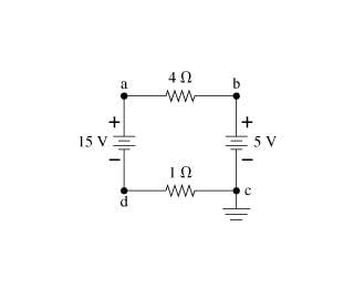

Determine the value of the potential at points a to d in the figure
I really have no idea on how to even approach the problem. If you could just start me off and tell me where to go it would be a huge help. Thanks!
Start with point (c) since it is grounded. Then figure out (b). (a) and (d) will involve a little algebra.
Kirchof's voltage law is useful here.
