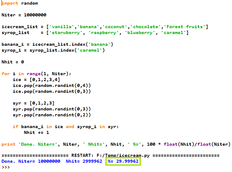

I see your answer is 29.99962%
But I can't grasp the solution itself...
Could you be more explaining, please?
This Python code is a "Montecarlo" simulation. It does 10.000.000 simulations of the case of getting the icecream and syrup.
The list ice is initialized with 5 different numbers, which represent the 5 different flavours.
The list syr is initialized with 4 different numbers, which represents the 4 different syrups.
The ice.pop(...) instruction, deletes one random item the from the list... so if we begin with the list containing 5 numbers (flavours), and we ice.pop 2 numbers, we end having a list with 3 numbers left (the 3 icecream flavours), because 2 are removed.
The same goes for the syr list.
At the end, if the ice list contains the number (index) of banana, and if the syr list contains the number (index) of caramel, then we account for one more hit, which means that randomly we got to a case in which we have a banana flavour with caramel.
We run this 10.000.000 times ... instead of you doing this tedious work manually, is a Python loop.
The result is 30% (you would have to run an infinite loop to have the exact number).

DesertFox said:
I can't understand it. :( :( :(
Just for the sake of interest, here is a similar simulation performed using Maple, but drawing only 10,000 ice-cream cones instead of 10,000,000. In the worksheet, B = number containing Banana ice-cream, C = number containing Caramel topping and BC = number containing both.
