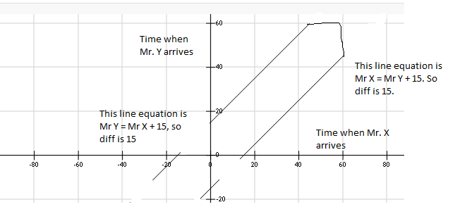

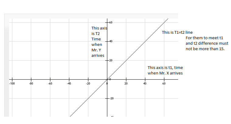

Draw the region in (t1,t2)-space. Basically, they meet if the point (t1,t2) near enough to the line t1=t2, and they fail to meet if the point (t1,t2) is too far away from that line.

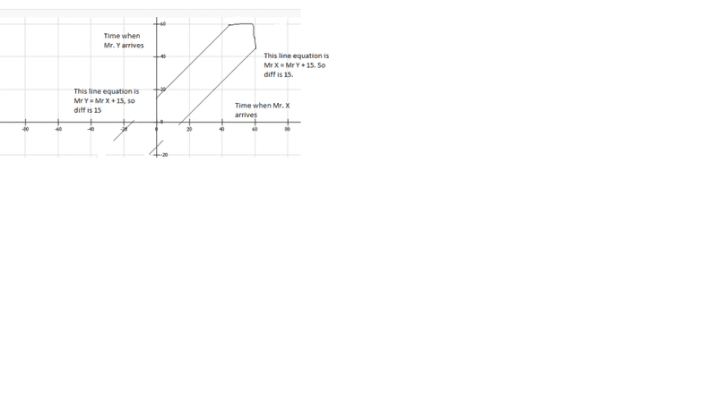

I plotted this graph.
Okay so mod of t1 - t2 must be less than 15.
I don't know what to do next. How is t1 = t2 line helpful.
Equation can be t1-t2 = 15, so t1 = t2 +15, this gives one line
and t2-t1 = 15. So t2 = t1+15. This gives other line. But where do these lines lead me?
So now how do i find probability. How is graphs helpful?
The equations are t1 - t2 < = 15, so t1 = t2 + 15. 15 is waiting time which can vary from 0 to 15. So this line is t1 = t2 + 15, to t1 <= t2.
Likewise t2 - t2 < =15, waiting time varies from 0 to 15, so region is t2 <= t1+15, to t2 <= t1.
So i got region where they meet that is the middle region between the lines.

In post #5 you went at the problem by summing over various integer-valued points that satisfied the "meet" condition. Now you have an actual drawing showing you directly which points satisfy the "meet" condition. Surely you can see how that is helpful?
Anyway, in the continuous time analysis, you integrate instead of summing, but to do that you need a probability distribution over the points (t1,t2). What distribution do you think you should use? It should match the type of probability distribution you used when t1 and t2 were integer-valued instead of continuous.
Also: looking at your drawing, the "meet" region has a more complicated shape than the "don't meet" region. Which would be the easier region to integrate over? Which calculation would be easier?
I thought about it. But i don't know how to go about it. Area seems the only solution, but i don't know why.
Area of region between lines can be
area of entire region (60 X 60) - (area of upper left triangle + area of lower right triangle)
and that is 60 X 60 - (1/2 X 45 X 45 + same as left term)
so that's like 3600 - 2025
so that's 1575 second square.
Entire area is 3600 sec square.
So probability can be 1575 / 3600 = 0.4375 = 7/16.

Area is relevant because you are (without really saying so) assuming a uniform probability density over the square ##S =[0,60] \times [0,60]##. In this case the probability that a point ##(t_1,t_2)## falls in some region ##A## in ##S## is just the ratio of the area of ##A## to the area of ##S##.
