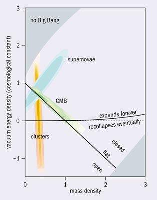

It can.
This image shows the Lambda-CDM model. As you can see, the dividing lines for open/flat and expand forever/recollapse are very different. The statement is particular for a Universe containing only matter.
Edit: Note that the observational data (implications are shown as coloured regions) suggest that we are firmly inside the expand forever regime while still being compatible with a flat universe.

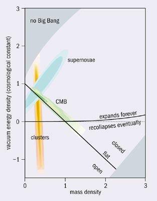

Thanks for this - what's the source out of interest?
