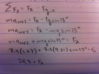

A shopper pushes a 7.3 kg shopping cart up a 13° incline, as shown in Figure 5-24. Find the magnitude of the horizontal force, F, needed to give the cart an acceleration of 1.67 m/s2.
Figure 5-24
All forces equations.
Help?
Realize that the applied force is horizontal, not parallel to the incline.
Ohhh, thank you, I got the answer!
