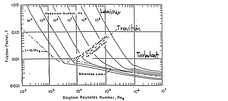

Where do you come up with your friction factor? The Chart we were given for the friction factor of a Bingham Plastic looks like someone drew it by hand, instead of a computer generated plot.
The reason I say that the change in pressure is zero is because when doing my mechanical energy balance, I am choosing the top of the tanks (which are said in the problem statement to be at the same pressure) as my points that I am doing the energy balance on. Why is the pressure difference not zero, when the problem says both are at 1 atm?
Caught an error: the reynold's number is wrong, I divided by the yield stress, not viscosity! I will keep working on it and post my next solution next time I get home to scan it. That is why you got such a strange calculation no doubt.

As I said earlier, this is definitely going to be a laminar flow, if you evaluate the reynolds number in terms of the non-Newtonian viscosity (the shear stress divided by the velocity gradient) rather the by using the Bingham "viscosity parameter" (μ =27Cp), which is not the viscosity of the fluid. The actual non-Newtonian viscosity is going to be greater than 200 Cp at all radial locations.
To solve this, you don't need to determine the friction factor, just as, for a Newtonian fluid, you can get the pressure drop/ flow rate relationship (Hagen Poiseuille) without implementing the intermediate step of determining the friction factor.
I looked up the solution for laminar tube flow of a Bingham plastic fluid, and manipulated the results to the following two equations:
[tex](τ_{wall}/τ_0)-\frac{4}{3}+\frac{1}{3}\frac{1}{(τ_{wall}/τ_0)^3}=\frac{(\frac{8V}{D})μ}{τ_0}[/tex]
[tex]μ_{wall}=\frac{(τ_{wall}/τ_0)}{(τ_{wall}/τ_0)-1}μ[/tex]
where V is the average flow velocity (0.284 ft/sec), μ is the Bingham plastic viscosity parameter, D is the tube diameter, τ0 is the yield stress, and μ_wall is the non-Newtonian viscosity of the Bingham plastic at the wall.
The first equation is used to solve for the ratio of the shear stress at the wall τwall to the yield stress τ_0. In this equation, for your particular problem, the right hand side of the equation is equal to 0.0322 (dimensionless). Once you solve for the ratio of the shear stresses, you can determine the shear stress at the wall, and then, the pressure drop (which is just 4L/D times the shear stress at the wall).
The second equation is used to determine the non-Newtonian viscosity at the wall, once you know the ratio of the shear stresses. Since a Bingham plastic is shear thinning, the viscosity at the wall will be the lowest of all the locations in the tube. You can then use this viscosity to calculate a Reynolds number for the flow and ascertain that the Reynolds number is indeed less than 2100.

OK. Your Bingham plastic slides 3 and 4 have what you need. The first equation on the 3rd slide can be worked into the form of the first equation I presented. Both my equation and this equation are implicit in the friction factor (mine is implicit in the wall shear stress, which is equivalent to being implicit in the friction factor). To make things easier for you, they give you the graph on slide 4, which is the explicit solution for the friction factor. Even though slide 4 is labeled Turbulent Bingham Plastic flow, the graph has a laminar flow region (the portions of the lines to the left of the dashed line labeled "transition") that you can use. You can see the word "laminar" written up top on this figure. This is the figure you need to use to get your answer. There is a worked example in your handout that pretty much shows precisely how to work the problem.
When you solve the problem using this figure, you can check your answer against my estimated value of the pressure drop I gave in my previous post.
Chet
How could I use the first equation in the 3rd slide (the nonlinear friction factor calculation) to the equation you wrote on post #11? They look vastly different to me
They do look different, but they're not. You want to know how to convert the equation on slide 3 to my equation. Here's how.
(1) substitute the equations for the Reynolds number and Hedstrom number into the equation on slide 3
(2) substitute the following for the friction factor: [tex]f=\frac{τ_{wall}}{\frac{1}{2}ρV^2}[/tex]
(3) Manipulate the equation mathematically until it is in the form I presented
You can see in the equation on slide 3 that there is a term with an f3 in the denominator; this will become the term in my equation involving the τwall3 in the denominator. You can also see in the equation on slide 3 that there is a term with an f in the numerator; this will become the term in my equation involving the τwall1 in the numerator.
Notice how much more simple the form of my equation is than the form of the equation on slide 3. This is because they forced themselves to work it into a form involving the friction factor, the Reynolds number, and the Hedstrom number. My equation only involves two parameters: the dimensionless parameter on the right side, and the ratio of the wall stress to the yield stress. However, my equation is customized to laminar flow, and is not easily extendable to turbulent flow.
