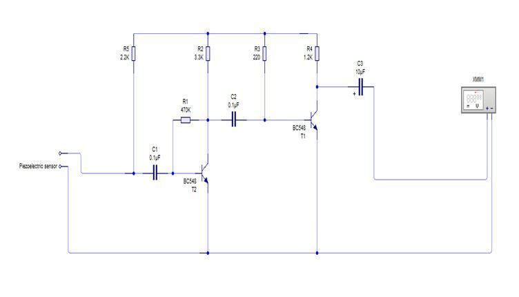

Yesterday I received a schematic diagram from my lecturer, it about piezoelectric energy harvester. Well, I'm not sure what the function of the transistor BC548. I think the transistors function as amplifier. Am I true? If someone could explain it to me detail, that will be better. Thank you and sorry for my broken english.
I doubt they are amplifiers if the intent is to harvest energy. I bet the intent is more related to keeping the current flowing in one direction.
The voltmeter is effectively measuring the potential difference over C3.
