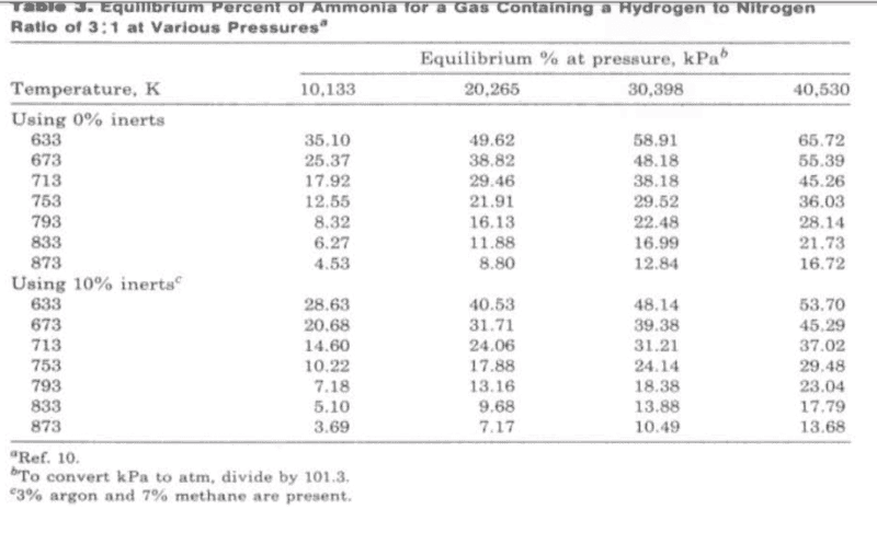

Usually we say that if a reaction $$ aA + bB ⇔ cC + dD$$ has ##K_{eq} > 1## the equilibrium is reached with more products than reagents. Otherwise if ##K_{eq} < 1## the inverse reaction is favoured.
Now let's consider the synthesis of ammonia: $$ 1.5H_{2} + 0.5N_{2} = NH_{3} $$
From letterature we know that @ T = 600K ##ΔG_{R} > 1 → K_{eq} < 1 ##. Now let's write the equilibrium equation (assuming perfect gases as equation of state): $$ \frac {P*y_{NH_{3}}} {(P*y_{H_{2}})^{\frac 3 2} * (P*y_{N_{2}})^{\frac 1 2}} = K_{eq} < 1 $$
It seems to me that the fact of ##K_{eq} ## being smaller than 1 is a meaningful information since I can increase the concentration of ammonia (##y_{NH_{3}}##) simply by increasing the Pressure. So if ##P→inf## then ##y_{NH_{3}} → 1## while ## y_{H_{2}} ## and ## y_{N_{2}} → 0 ##.
Conclusion: working at high pressure I have lots of ammonia even thought K_{eq} < 1. Why then should I worry about K_{eq}? I mean if I MUST have products no metter what I just have to work at higher pressure (it this example).

Mhm, I found that ##y_{NH_{3}} = 0.65 ## @ T = 633K and P = 40kPa at equilibrium...
Does it mean is still not favoured?
I am under the impression amount of ammonia produced is quite low, but perhaps the numbers I recall seeing were results of the measurements of the real reaction taking place in flowing gas and not getting to the equilibrium.
Don't know about the whole precess yet, but I refer to this table I have (from my professor)... Sorry but I forgot where he got it
The pressure P is not 40 kPa, but about 40000 kPa in this case!
Yes, thank you. I lost 10^-3 on the way... My point should have been clear anyway
In order to optimize an industrial process like the NH3 synthesis, one needs a lot more than saying: “Why should I worry about Keq. In case Keq < 1, simply increase the pressure.”
