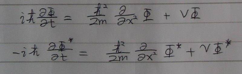

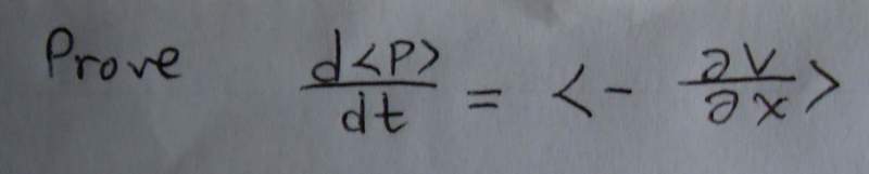

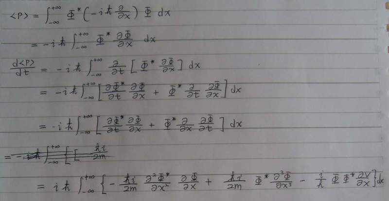

3. The Attempt at a Solution
I almost get the answer as long as I can cancel out the first 2 terms.
But they are different, what can I do now?

now you do the integral
the first term will cancel after 2 applications of integration by parts. the second term will need some adjustment with Schrödinger equation and cancel out. at the end you end up with a term thatll look like the potential energy only from the Schrödinger equation.
i believe you can find the direct calculation on introduction to QM by griffiths, not certain though
