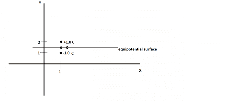

I have provided both problem and solution(almost)but the problem is I did not understand the solution.First of all
I did not understand the question what we are told to determine?

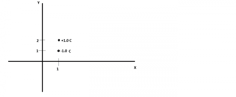

I locate the charges as follows
Did you write the red part? It seems pretty sensible to me, so if you wrote it I think you've finished.
If it's a supplied solution and you don't understand it, can you explain what it is that troubles you about it? That would make it easier to help.
I don't know if this is relevant to your concern but I'll point out anyway that the surface they've asked you to identify is the only flat equipotential surface. All the others curve away from the flat surface. So the problem in general isn't as trivial as it might seem (if it's the apparent triviality that worries you).

I mean the question mentioned two charges located at rest and then suddenly it (the question)points out at equipotential surface.I don't understand from where does this equipotential surface come?

Do you understand what an equipotential surface is?
The flux is radiating radially outward for positive charges and inward if negative. For stand alone charge, any circle around it will be equipotential. If you introduce another charges, every point is determine by the resultant potential.
Equipotential surfaces are surfaces of constant scalar potential.
Right. So, in the configuration of charges given, you are trying to find the locus of all the points at some particular potential. In general that locus will be a surface, but it is here given as a 2D problem, so you are just looking for a closed curve in the plane. You are told a point that is on it (which effectively determines what the constant potential is).
Suppose the point (x, y) is on the equipotential. Write out the expression for the potential at that point.

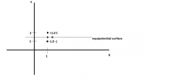

Potential of the equipotential surface shown(by me in post #9)
##V##=##\frac{q}{4πεo r}##
Potential due to +1.0 C=##\frac{1}{4πεo 0.5}##
Potential due to -1.0 C=##\frac{-1}{4πεo 0.5}##
Net ##V## at the point =0
Hence this potential is constant for the entire surface
Right?

You've calculated the potential at a single point.
Right?
The trick is to realize that, due to symmetry, the potential at any point on the plane y = 1.5 will be zero.

Equipotential surface (in this case equipotential lines in the x,y plane -- where line can be curved or straight) is the collection of points with the same potential. You have been given two points for which you calculate the potential to be zero. Other points for which the potential is also zero will have coordinates that satisfy andrewkirks last equation in his post #17 with P = 0.
When P = 0, you can reduce that equation to ##\ \ d(x,y)(1,1)=d(x,y)(1,2)\ \ ## which is the case for all points with y = 1.5.
y=1.5 is the equation of a straight line .
No fancy math; easy exercise.
