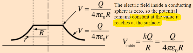

If I assume the sphere is charged in question 2, then the best answer would be 2(b) Remains constant.

But, if a spherical conductor is uncharged and is not in a region of electric field, then we could say that the work done against electrostatic forces in bringing a unit +ve test charge from infinity to a point inside the conductor would be zero since there is no electric field i.e. no electrostatic force against which some work is being done. Therefore, the potential inside the conductor would be zero. I'm not sure if there is something wrong in my above logic.
What's wrong with your logic is that the positive test charge will induce charges on the skin of the sphere which will then produce a dipolar field that will exert an attractive force on the test charge. The induced charges are there to ensure that the sphere remains an equipotential but at a higher value of the potential. The force on the test charge would be the same as the Coulomb attraction with its image charge inside the sphere. $$F=-\frac{q^2}{4\pi\epsilon_0}\frac{RD}{\left(D^2-R^2\right)^2}$$ where

Yes, I get it. That's why the test charge is very small so that it doesn't disturb the existing field or the absence of electric field.
I think negative work would be done on the test charge against electrostatic forces (because applied force on test charge and test charge displacement would be in opposite directions). But as the test charge approaches 0, the negative work done would also approach 0. So, in the limiting case, could we say that potential would also approach zero for a point on the surface of uncharged spherical conductor?
(##V = \displaystyle{\lim_{q \rightarrow 0^{+}} {\frac {W} {q} }} ##)
