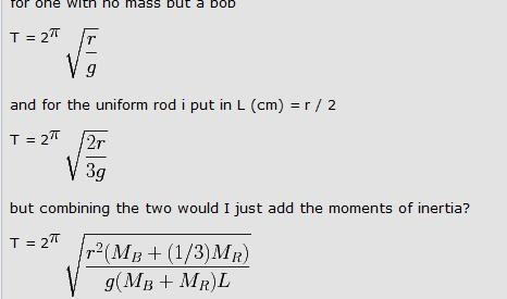

hey sorry about this again but I'm having trouble with some questions :o:
http://www.physics.ox.ac.uk/Admissions/undergraduate/admissions_test/tests07.pdf
page 6) okay well the bit I'm not sure about here is that L(cm) seeing as it is the distance to the COM i substituted r/2 for the uniform rod and r for the one with the bob giving me;
Handwritten-style typeset derivation comparing pendulum periods: T = 2π√(r/g) for a bob on a light rod, T = 2π√(2r/3g) for a uniform rod, and combined T = 2π√(r²(M_B + (1/3)M_R)/(g(M_B + M_R)L)) on a plain background.
i guess it makes sense because it would go to my simplified versions when simplified
then with the 24 hour one it's really tricky...
i worked out how much a time period would be to give a difference of 1 day + 1 second, then I worked out what the difference in r would be which gave me;
0.469K for brass and
7.429K for invar, do you think that's reasonable?
note i used the formula for a pendulum of negligible mass and a mass on the end.and
page 10) question 6, I literally have no idea, i KNOW that it's a silly rule or something reguarding a equilateral triangle in a circle or some rule you can draw on however I'm just blank on this one, any pointers in the right direction would be great...
thanks again!
