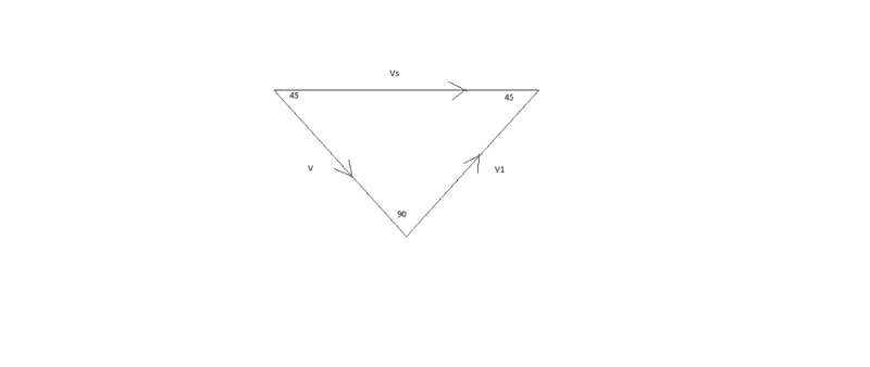

Try to draw a vector representation the velocity of the shadow and the velocity of the horse and how they are related in terms of the angle rotated. I think if you can do that it will help a lot.

I tried but I can't solve this problem. Can someone explain me?

Can you post your sketch of the problem?
A hint: Consider the angular velocity of the line connecting the light, the horse, and the wall.
Vectors form isosceles triangle with two 45 degrees angles and one 90. So Vs=√2*V. That sounds too simple.
