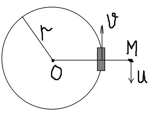

I remembered a pretty high school problem from kinematics. But it seems it can help even undergraduates to develop their understanding of what a relative motion is.
Consider a railway circle of radius ##r##. Assume that a carriage running along this circle has a speed ##v##. See the picture. A fly ##M## flies in the opposite direction and has a speed ##u,\quad |OM|=b##. Find a speed of the fly relative to the carriage.
The obvious incorrect answer is ##u+v## while the correct answer is ##u+bv/r##.
The point is as follows. The velocity of any point is defined relative to a frame. To say "velocity relative to the carriage" is the same as to say "velocity relative to a frame connected with the carriage" Thus in this problem the frame rotates about the point ##O## with the angular velocity ##v/r##.

I am not clear on the facts. Is the fly prescribing circular motion about O in the clockwise direction?
In any event, velocity of the fly relative to the carriage frame would just be:
##\vec{u}-\vec{v}## where the velocity vectors ##\vec{v}\text{ and } \vec{u}## are constant magnitude but one or both constantly changing direction.
At the moment that they are both positioned as shown, the relative motion of the fly to the carriage would just be ##|u|\hat{-j}-|v|\hat{j}=-(|u|+|v|)\hat{j}## where ##\hat{j}## is the unit vector in the page-up direction.

The question is the speed of the fly as perceived by an observer in the carriage. We can simplify it by first making the fly stationary and having the carriage move in a straight line. Now the answer is v. But then add that the observer is turning around within the carriage at angular rate v/r. That adds (v/r)(b-r) to yield vb/r.

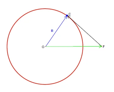

??? The velocity of the carriage relative to the fly is the time rate of change of the displacement vector of the carriage to the fly. In this diagram, ##\vec{v_{c-f}}=\dot{\vec{FC}}##:
Diagram of a red circle with centre O, a blue radius vector R from O to a point C on the circumference, and a black line from C to a point F outside the circle, with a green arrow from O to F.
But ##\vec{FC}=\vec{R}-\vec{OF}## so ##\vec{v_{c-f}}=\dot{\vec{FC}}=\dot{\vec{R}}-\dot{\vec{OF}}=\dot{\vec{R}}##
AM
