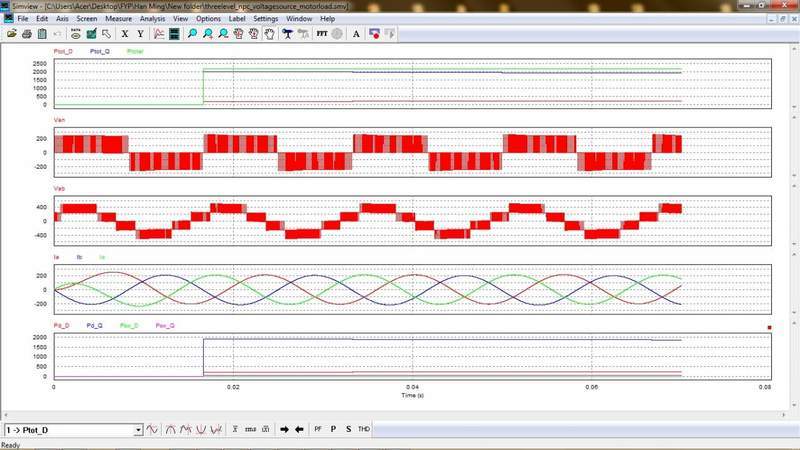

hereby i attached the waveform picture of npc inverter. here is the parameters that use for npc inveter.
__________________________________________________________________________________
DC Bus Voltage : 500 Vdc
AC Output : 250 V (line-line, rms), 60 Hz, 0.8 power factor (lagging)
Switching Frequency : 8 kHz
Capacitance : 2200 µF
Resistance : 1 Ω
Squirrel-cage Ind. M. : default
Mechanical Load : default
and here is the result that i get from simulation for npc inverter.
The following losses results are obtained from the PSIM simulation:
Diode Conduction Losses : 0236.54 W
Diode Switching Losses : 000.060 W
Diode Total Losses : 0236.60 W
Transistor Conduction Losses : 1868.69 W
Transistor Switching Losses : 0067.90 W
Transistor Total Losses : 1936.60 W
Total Losses per Module : 2173.20 W
Line to neutral voltage : 256 V
Line to line voltage : 499 V
Output current line A : 56.63 A

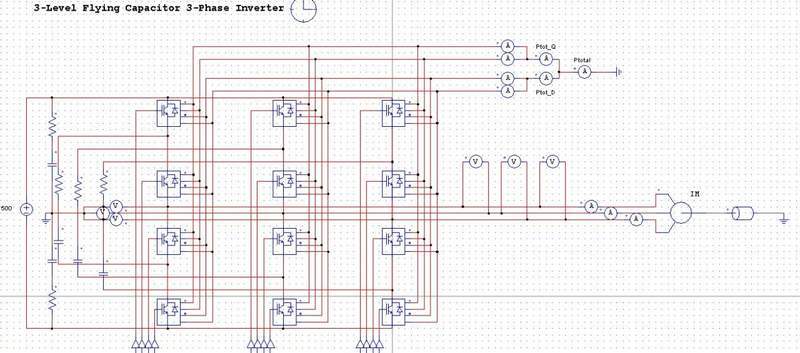

is it possible for me to get the exact waveform like 3 level npc 3 phase inverter, but using 3 level flying capacitor 3 phase inverter method? what would be the value for the capacitor and others? i also attached the schematic for 3 level flying capacitor 3 phase inverter. what should i put the value for all component?

oh btw mr. meBigGuy, flying capacitor is for convert dc to ac, not stepping up voltage. :)
I know nothing about them. Sorry
