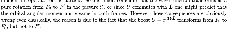

Hello, I'm coming back on this problem because I think there is still some confusion. Consider the ground state \big|\psi(t)\rangle in the rotating frame. Then the average of the angular momentum in this frame is given by
\big\langle\psi(t)\big|\mathcal L_z\big|\psi(t)\big\rangle
Now if I want to know this average value measured in the lab frame I can either transform the ground state to the lab frame and sandwich \mathcal L_z in between, or directly measure \mathcal U^\dagger \mathcal L_z\mathcal U in the ground state, which are equivalent. The problem is that [\mathcal L_z,\mathcal U]=0, so I will get exactly the same value in both frames... which cannot be! The two measured values of the angular momentum should differ by a constant proportional to \omega.
What am I missing?
The time evolution in the rotating frame comes from the full Hamiltonian which contains an angle-dependent potential. Therefore, $$[\mathcal L_z,e^{-i \mathcal H t/\hbar}]\neq 0$$ I haven't thought about this aspect of the problem before, so don't trust me too much.
I tried to think by analogy with the case where the system is in uniform translation instead of rotating. Then everything works well. The unitary operator of interest in this case is \mathcal U=e^{-i\frac{mv}{\hbar}\mathcal X}, and it transforms the momentum as expected, \mathcal U^\dagger\mathcal P\mathcal U=\mathcal P-mv.
This would suggest that the unitary operator for the rotating case would actually be something like \mathcal U=e^{-i\alpha\Theta}.
I am more and more convinced that the operator \mathcal U=e^{-i\frac{\omega t}{\hbar}\mathcal L_z} is NOT the unitary operator that transforms from the lab frame to the rotating frame. This operator only performs a ``static" transformation to a rotated basis with an angle that depends on time, but this is not a ``dynamical" transformation to a rotating frame.
Let me explain what I mean with the example of a Galilean tranformation, for which there is no problem. Consider the one-dimensional Hamiltonian of a single particle in a potential, \mathcal H_o=\frac{\mathcal P^2}{2m}+\mathcal V(\mathcal X). And consider the operator \mathcal A=e^{i\frac{vt}{\hbar}\mathcal P}. It is straightforward to check that this operator performs a time-dependent translation of the potential:
\mathcal A^\dagger\mathcal V(\mathcal X)\mathcal A=\mathcal V(\mathcal X-vt).
However, it is clear that it does not perform a Galilean transformation, as it commutes with the momentum operator and leaves it unchanged:
\mathcal A^\dagger\mathcal P\mathcal A=\mathcal P.
On the other hand, the operator \mathcal B=e^{-i\frac{mv}{\hbar}\mathcal X} leaves the potential unchanged and performs a translation of the momentum:
\mathcal B^\dagger\mathcal V(\mathcal X)\mathcal B=\mathcal V(\mathcal X),
\mathcal B^\dagger\mathcal P\mathcal B=\mathcal P-mv.
Therefore the unitary operator that performs a transformation from the lab frame to a frame moving a constant velocity, that is to say a Galilean transformation, is given by:
\mathcal G=e^{i\frac{v}{\hbar}(t\mathcal P-m\mathcal X)}.
So you see that the \mathcal A operator only translates the coordinates as a function of time, but it does not change to the moving frame. And \mathcal A is the direct analog of \mathcal U=e^{-i\frac{\omega t}{\hbar}\mathcal L_z}. The latter rotates the coordinates, but it does not change the angular momentum, so it does not change to the rotating frame.
Actually, if we are interested at time t=0, it is sufficient to consider the \mathcal B operator, which is exactly the operator used to perform Galilean transformations in the article Superfluid density in continuous and discrete spaces: Avoiding misconceptions (http://journals.aps.org/prb/abstract/10.1103/PhysRevB.90.134503).
I just don't know how to generalize this to a rotating frame.

Here is another very simple argument that supports the fact that \mathcal U(\vec\omega)=e^{i\frac{\vec\omega t}{\hbar}\cdot\vec{\mathcal L}} does not transform the system from the lab frame to the rotating frame. Consider a general Galilean transformation with velocity \vec v. We can easily check that the unitary operator \mathcal G(\vec v)=e^{i\frac{\vec v}{\hbar}\cdot(t\vec{\mathcal P}-m\vec{\mathcal R})} does the job:
\quad\mathcal G^\dagger(\vec v)\vec{\mathcal R}\mathcal G(\vec v)=\vec{\mathcal R}-\vec v t
\quad\mathcal G^\dagger(\vec v)\vec{\mathcal P}\mathcal G(\vec v)=\vec{\mathcal P}-m\vec v
Now, it is straighforward to check that \mathcal G(\vec\omega\times\vec{\mathcal R})=\mathcal U(\vec\omega). Thus, the operator \mathcal U(\vec\omega) appears as a particular case of a Galilean transformation, hence it cannot describe a transformation from the inertial lab frame to the non-inertial rotating frame.
