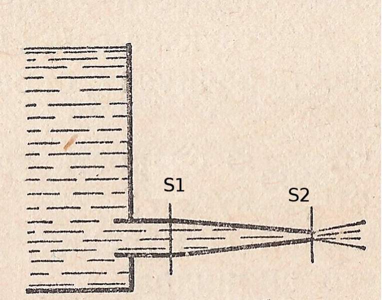

Water is gathered in a column of height h, above above a distributing pipe.
The pipe then narrows from cross sectional area S1 to S2(S1>S2), after which, the fluid exits(as shown in the attached figure)
Find the total horizontal force(in the direction of the fluid's flow) acting on the pipe.
(s1 = 3.0 cm^2, s2 = 1 cm^2, h = 4.6 m).

I started by defining the force:
Over a certain, small, pressure drop, the (minute) force generated is:
[tex]dF = dP\cdot S(x)[/tex]
Where S(x) is cross-sectional area over the pressure gradient).
I assume that, before the pipe starts to constrict, as the fluid is taken to be ideal(inviscid), there are no force contributions there.
Therefore, according to Bernoulli, a small chance in pressure would be directly related to an alteration of the velocity, by differentiating 1.:
[tex]dP = \rho v dv[/tex]
And from continuity conditions:
[tex]S_1 v_1 = S(x)\cdot v(x) = const \\ v(x) = \frac{S_1 v_1}{S(x)} \\ <br /> dv = \frac{-S_1 v_1}{{S(x)}^2}dS \\[/tex]
Plugging both into dF:
[tex]dF = dP\cdot S(x) = \rho vdv S(x) = -\rho\frac{S_1 v_1}{{S(x)}^2} \frac{S_1 v_1}{S(x)}S(x)dS = -\frac{\rho{S_1}^2{v_1}^2}{{S(x)}^2}dS[/tex]
Integrating, to obtain F, S, going from S1, to S2:
[tex]F = \rho {S_1}^2{v_1}^2 \int_{S_1}^{S_2}\frac{-dS}{{S^2}} = \rho {S_1}^2{v_1}^2 \cdot (\frac{1}{S_2}-\frac{1}{S_1})[/tex]
Now, since v1 is the velocity the fluid gains from its column, i.e., due to gravity, Bernoulli gives us:
[tex]v_1 = \sqrt{2gh}[/tex]
Inserting all the given data gives me:
(rho is the density of water: 1 g/cm^3)
[tex]F \approx 55 N[/tex]
Yet the correct answer is, F = 6 N!
What have I done wrong?
Any help would be greatly appreciated,
And I am as always thankful for your time and attention,
Daniel

danielakkerma said:
Bernoulli gives us:
That would be true if the water were going straight out to atmospheric pressure there. Applying Bernoulli to the transition from surface of water to start of pipe: v12/2+p1/ρ=gh. However, I get 12N, not 6.
Interesting, could you elaborate on that?
I thought that given that the water was still in the beginning, it was simply a question of converting the "weight" of the water to Dynamic pressure.
It's just like water flowing out of a tank, with a hole in one side.
How did you arrive at 12N?(that's pretty close! I may have missed a factor of 1/2, so I'd like to trace your answer, if you would indulge me)...

danielakkerma said:
For a small fluid parcel with volume dV, positioned inside the draining pipe(and initially at rest),
But that is not a feasible combination. If it is inside the pipe it must already be moving. You have to think of the entire tank as part of the flow.
If water enters the pipe at speed V1, pressure P1 (above atmospheric), area S1, and leaves at speed V2, pressure P2 (= atmospheric, i.e. 0), area S2, we have:
gh = V12/2+P1/ρ = V22/2
R (mass flow rate) = V1S1 = V2S2
Whence V2 = √(2gh), V1 = √(2gh)S2/S1, P1 = ρgh(1-S22/S12)
To get the backthrust from the pipe, one way is to compare the applied force at the start of the pipe, P1S1, with the resulting mass*acceleration, ρR(V2-V1). Take the difference of those and you should get 6N (I made a mistake before).
I look at it as follows:
It's the horizontal component of force that matters. So dF = pdS since the area under question is the difference in areas between S+dS and S = dS = 2πr dr, r = radius.
I also figure that according to Bernoulli applied to the tank's surface and the final outlet point 2 is (atmospheric pressure disregarded at both ends)
0 = - ρgh + ρv22/2 → v22 = 2ρgh so working backwards into the pipe,
ρv2(x)/2 + p(x) = ρv22/2 where v(x = 0) = v1.
Combined with S(x)v(x) = S2v2 you can now integrate dF from x = 0 to x = L, L = length of tapered section. S(x) = πr2(x).
I have not done the numbers.

I solved this problem independently, making use of an overall momentum balance as the final step, and got:
[tex]F=\rho ghS_1(1-\frac{S_2}{S_1})^2[/tex] which gives a force of 6 N. As haruspex indicated, it was unnecessary to integrate along the length of the taper. I might also mention that haruspex hinted at using an overall momentum balance, but no one seemed to be very receptive to this idea. Too bad. It seemed obvious to me that this is what was needed.

The overall momentum balance in the axial direction (on the fluid) gives:
[tex]P_1S_1-P_2S_2-F=\rho v_2^2S_2-\rho v_1^2S_1[/tex]
with [itex]P_2=0[/itex] and with [itex]\rho v_2S_2=\rho v_1S_1[/itex]
For an ideal (inviscid) fluid, this gives a value of F = 6N, irrespective of the transition from S1 to S2, provided only that there is enough pipe length following the transition for the streamlines to straighten out again before the fluid exits the pipe.
