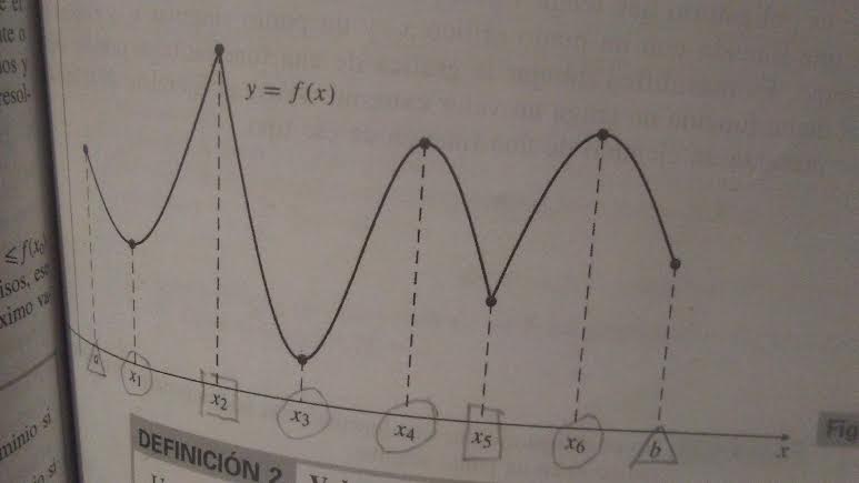

Hi, PF, I've got a quote, and a philosophical question
Figure shown suggests that a function ##f(x)## can have local extreme values only at ##x## points of three special types:
(i) Critical points of ##f## (points ##x## in ##\mathfrak{D}(f)## where ##f'(x)=0##)
(ii) Singular points of ##f## (points ##x## in ##\mathfrak{D}(f)## where ##f'(x)## is not defined)
(iii) Endpoints of the domain of ##f## (points in ##\mathfrak{D}(f)## that do not belong to any open interval contained in ##\mathfrak{D}(f)##)

In the figure you attached, points a and b are, respectively, a local maximum point and a local minimum point. At neither one is the derivative of the function equal to zero, and at neither is the derivative undefined (although you will need to use one-sided limits for each one).
Clearly each of these points has a y-value greater/smaller than all other points in the immediate vicinity, which makes them local extreme points.
Still stucked, I've read it, but... Could explain further?
Questions:
Why ##a## and ##b## are, respectively, a local maximum point and a local minimum point?. It's clear what you say later, but I don't relate it with the sentence I want to understand.
##a## is a local maximum for the function because it fits the definition of a local maximum.
1. It is within the domain of the function.
2. There is a neighborhood around a within which all points that fall within the domain of the function have function values less than or equal to that of a.
Similarly, ##b## is a local minimum because it fits the definition of a local minimum.

To add to what @jbriggs444 already said, look at the graph you attached. Are there any points near a that have larger y values? Are there any points near b that have smaller y values?
Here "near" should be interpreted to mean between a and x1, and between x6 and b, respectively.

Might the following capture the concept of neighborhood for the case of ##a##, always in a naive way?
$$\exists{\;h>0}\quad\mbox{such that if}\;x\in{(a-h,a+h)}\cap{\mbox{dom}(f)}\quad\mbox{then}\;f(x)\leq{f(a)}$$

$$\exists{\;h>0}\quad\mbox{such that if}\;x\in{(a-h,a+h)}\cap{\mbox{dom}(f)}\quad\mbox{then}\;f(x)\leq{f(a)}\Leftrightarrow$$
$$\exists{\;h>0}\quad\mbox{such that if}\;x\in{[a,a+h)}\cap{\mbox{dom}(f)}\quad\mbox{then}\;f(x)\leq{f(a)}$$

Point a is apparently the left endpoint of the domain, so my preference would be the second statement. The first one isn't wrong, but needlessly mentions points in the interval (a - h, a).
