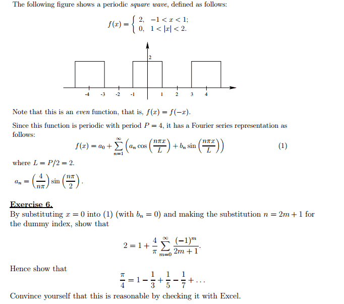

Is there some properties I should be aware of?
after making the relevant substitutions, I ended up with
$2 = 1 + \sum\nolimits_{m=0}^\infty \frac{4}{(2m+1)\pi}\sin(\frac{(2m+1)\pi}{2})$

Rearrange to:
$$\frac{\pi}{4}=\sum_{m=0}^\infty \frac{1}{2m+1}\sin\left(\frac{(2m+1)\pi}{2}\right)$$
and ask yourself what values does the sine of odd half multiples of $$\pi $$ take?
