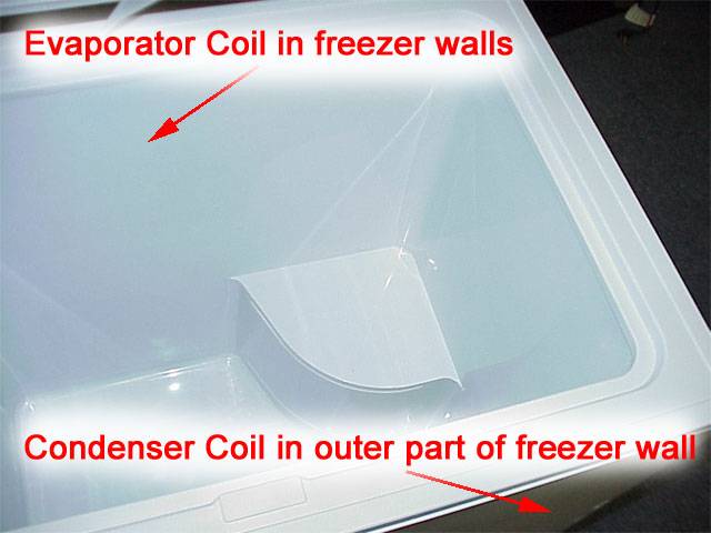

Lining the interior walls of a chest freezer with insulation will hinder the coils from freezing the food.
some of the food you put in there will then not freeze for a week, which can make for some ghastly culinary disasters and perhaps trips to the doctor and/or hospital. One wants the food to freeze as fast as possible to avoid bacteria growth.

Any extra measure would require some extra considerations. I would never suggest just lining the inside of the freezer. My suggestion was to put already frozen items in ‘local’ insulation. Insulated shopping bags or expanded polystyrene boxes would give extra protection. A frost free freezer would deal with condensation as usual in the intermediate voids - as it does between chicken and beef pieces in their own bags.
I already made the point about freezing stuff down before putting it in extra insulation.
To the point about slowing freezing: the metal shelves have refrigerant tubing running underneath, so I should be fine putting food in on those to chill.
A bit of 'management' would be needed here. Things would spend a few days next to the chilling panels / shelves and then be put in the extra insulation.
