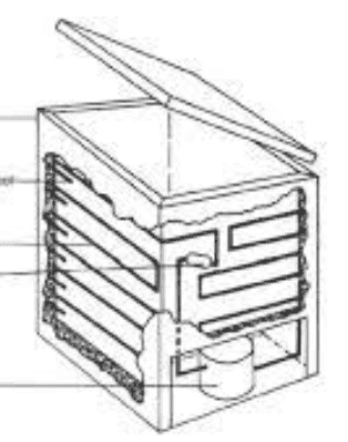

Is a shell approach feasible? Instead of an upper / lower configuration, install a shell around the inside of the freezer and stack ice-packs inside the shell, water or blue-ice or anti-freeze or whatever, inside plastic bags or hard containers. The shell material to keep the heat-sink liquid containers stacked in place and separate from the food in main inner compartment could be made of light metal grill plates. This would better match the existing coil design of the freezer you show, I am assuming that coil placement is typical of such freezers. It would also keep the temperature more uniform than having all of the cold heat-sink liquid at the bottom, and room could be kept to allow for expansion if the liquid freezes.
I like that. Less modification as you said. The shell barrier could be closed cell foam.
