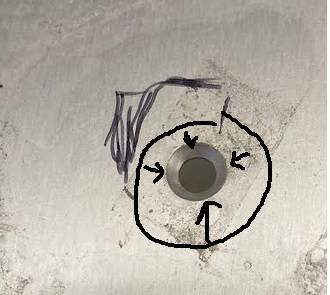

I need replicate a hole that has some kind of 'funnel' around it (see picture attached, arrows), so that screw caps get completely flat once they go through it, without protruding. Does anyone know what type of tool is needed to accomplish this? thank you
That is a countersunk hole. An oversized bit can work if you are careful and not too fussy. Google countersinking tools and you should come up with several solutions.

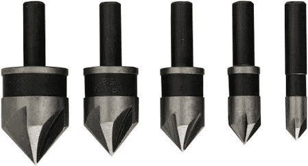

Also, if you already HAVE a hole and just want to add the countersink (what you call the "funnel") you can use a pure countersink bit:
There are also different kinds of those bits (different angles and different #s of flutes) to better accommodate different materials.
berkeman said:
Yep, one of the most used drill bit kits in my woodshop. :smile:
Yep, me to. I have the exact same set plus a different older one (that is less precise)
