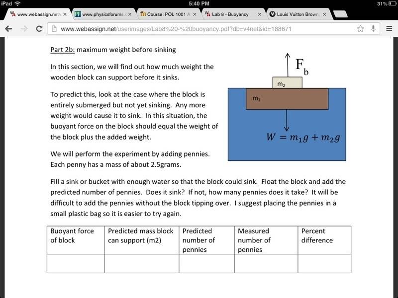

Wooden block: Mass: .095. Weight: .931. Volume: 2.03E-4. Density: 467.98. Buoyant force of block: 1.9894.
- Predict how much weight the wooden block can support before sinking.
W= m1g + m2g
Not sure where to start. If someone could just point me in the right direction that would be great! I have tried many things that haven't worked...
Here is a picture of the whole lab section:
  • Diagram of a wooden block m1 floating fully submerged in water with a stacked block m2 on top, showing upward buoyant force Fb and downward weight W = m1g + m2g.

Units: mass: kg, weight: N, volume: m^3, density: kg/m^3, buoyant force: N.
The equation I'm looking to use is W=m1g + m2g and I need to find what m2 is. I'm not sure where to begin plugging in for this equation though. Using the above info maybe someone could help me?

Archimedes principle: buoyant force= weights of displaced fluid
Well done:
specifically, an object floats when the buoyancy force is equal to it's weight.
This means: a floating object displaces an amount of fluid equal to it's own mass - but a sunk object, or an object just about to be sunk, displaces fluid equal to it's own volume.
So - what is the buoyancy force on the block when it is as pictured.
Per your question: how much extra mass must you pile on, for the block to float with it's top surface exactly level with the top of the water?
.105 kg was my final answer which proved tone correct. Thank you very much.

Isn't the buoyant force given in the OP?
It says "Buoyant force of block: 1.9894. ".
As well as the block's weight. You just need to subtract the two.

That's right - all that was needed.
To get there requires realizing what "buoyant force" actually means...
