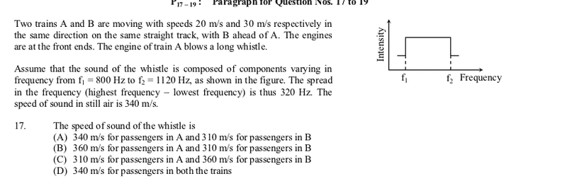

What will speed of sound for sourse and observer if both are moving wrt air?

see attachment that contains full question.
firstly read paragraph then see on question.
velocity of sound will be 340ms-1 wrt air or ground(since air i snot blowng).
Now speed of soud wrt train A= speed of sound wrt ground - speed of train A=340-20=320.
speed of soud wrt trains B= speed of sound wrt ground - speed of train B=340-30=310.
there is no such option. ?
where am i doing it wrong.
thnks.
waiting for ur valuable reply..

The question seems ambiguous to me. The speed of the sound with respect to what? The air? (I suspect that that's what they want.)

When I have been in my car and sounded the horn, the pitch sounded the same whether I was stationary or driving down the highway, so I suspect the pitch and speed of the wave to the passengers on train A will be the same as when stationary, so 340.
Train B is moving away from train A so the pitch will sound lower. If the sound is traveling slower, relative to a passenger, the pitch might do that.
I must say I am most uncomfortable with this question referring to the speed of the sound, rather than the pitch of the sound - [though that is varying]
EDIT: I agree with Doc Al; this is a very poorly worded question.

sometimes personal experinces are not as they are in ideal physics. Similar is here.
After all it's answer is B.
Now think once again on it.

yes that is with respect to air.;

Is that with respect to the air inside the train - the air that is moving along with the passengers - or with respect to the air that is outside the train, seemingly moving past the passengers because it is actually still?

sirens of train are usually not placed inside the train. they are placed on the roof of engine.
When it comes to speed of soud wave it doesn't depend on the frame. It speed is always 340 ms-1 with repect to air. no matter how air is flowing.

Right you are then. So you now realize the answer is D then don't you?

Last day i ask this question to my techer and he told me the correct answer. And that is as below.
since passenger in train A must seated behind the sren so sound of siren will reach till him with velocity -340.(negative for direction opposite to that of train).So relative velocity becomes 340+20=360;;;
that's answer.
Good thing about the answer is that, that the concept i apply was correct but i did a mistake.
I think both of u agree with my answer.
