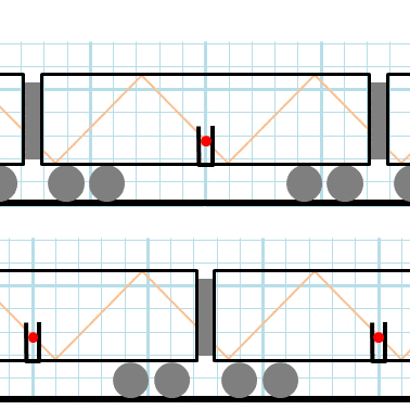

You're confusing a very simple matter. Imagine someone is on a train, throwing a ball up and down. To them it goes straight up and down: from point D to E and back down to D . But, to someone watching the train go past, the ball will go up and down in a curve: the ball will be thrown from point A, reach point B and be caught at point C. Tha ball does not need to be thrown "at a diagonal".
Your real problem here is not SR or light or length contraction of time dilation; it's a basic understanding of two reference frames, moving with respect to each other. The motion of an object or a light ray must be different in the two frames.
I'm in a train and it's raining. The streaks of rain on the window point towards the back of the train. Everyone agrees this, but they don't agree why. To me, the train is stationary and the rain is falling on a diagonal. To an observer on a platform the rain is falling vertically but the train moves while the drop is in the process of striking it.
The same thing is happening with the light pulses. Some people describe them as moving diagonally, some as moving vertically. They are different descriptions of the same thing.
I think I can see where you are going wrong. You wrote about your first diagram that the two experiments were in different frames. No. A frame is not a thing that you can be in or not - a thing is in all frames. A frame is just a point of view. You have drawn two pictures of the same experiment taken from different points of view - one moving with respect to the experiment and one not. Just like the rain and the train. And just like the rain and the train, if you look closely at the workings then you will find two different descriptions of every bit of the process, linked by the Lorentz transforms, that explain why each perspective sees what it sees.
A laser is a pair of mirrors with a gain medium between. In the frame where it is stationary the mirrors repeatedly reflect photons bouncing vertically up and down, so it is reasonable to expect the beam to come out vertically. In the frame where it is moving the mirtors reflect photons moving diagonally so we expect the beam to come out diagonally. It's the same photons, just a different description of what they're doing.

Maybe this diagram helps:
DrGreg said:
Here's something (it could be a pulse of light, it could be a ball) bouncing up and down in a train.
An observer in the train (top) infers the thing is moving vertically up and down.
An observer on the ground (bottom) infers the thing is "sliding sideways" in a zig-zag path.
This is valid in both relativistic and Newtonian mechanics.

You are getting dangerously close to discussing aberration of light.
Another source is here, starting about half way down. Look for "Meanwhile, Einstein's 1905 paper on the electrodynamics of moving bodies . . ."
The maths might (or not) be a challenge, but those are the answers that I think you are looking for.
Oh, it's you @m4r35n357 . I just saw you relativistic animation video in other thread. A good video.
Cheers. I hope you got the point that once you consider more than one spatial dimension (which is what I picked up on), angles of light travel become very important, and change from one frame of reference to another.
This is IMO where SR becomes really cool, as you can do all that visualization stuff with just 2 space dimensions and one of time. This keeps the algebra manageable.
On the other hand if that is not where you are really going with this then I apologize for butting in!
You tell me :smile:
I only know SR in 1 spatial dimension, non acceleration frame. That's why I haven't understood Bell Paradox, yet.
Thank you very much for you help all this time.
The speed of light is invariant in all frame.
I thought the angle, too. Mea culpa :smile:
