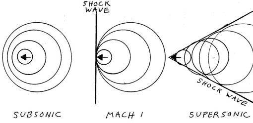

Anything that moves into a fluid creates pressure waves. Pressure waves are the same thing as sound waves, only much, much more stronger. Just like sound waves, they travel at the speed of sound, which mostly depends on the local temperature in an ideal gas.
If the object that created the sound wave by pushing on the fluid goes faster than the speed of sound, then the 'second' pressure wave will reach the 'first' pressure wave and they will add up, thus building up the pressure. When this is the case, something has to give up at some point and that is when there is a release of energy (kinetic energy is converted into thermal energy). This is called a shock wave and you can hear a sonic boom when it passes you by.
That being said, pressure waves travel into the fluid, so if the fluid moves, the velocity of the fluid is added to the one of the pressure wave.
The shock wave (where the pressure waves pile up) has a defined position in space. To hear the sonic boom, you just need to be at that location. It doesn't matter if you move or not. The shock wave location depends only on the position of the source with respect to the fluid:
You cannot hear the shock wave you've created, as it will always be in front of you.
That's not really how a shock wave is formed. Shock waves occur when the fluid has to actually change velocity in a supersonic flow, so you'll only get them immediately around the airplane where the flow has to turn or slow down (and that turning or slowing is propagating into the fluid faster than a small amplitude disturbance would, so the flow is unable to react to the object until the shock itself). Both of what your diagram labels as "shock waves" would be more accurately described as sonic booms or the mach cone. Shock waves can also have different angles from what your construction would imply - a shock wave at mach 5 can still be perpendicular to the incoming flow, for example.
What your diagram does show though is how the sonic boom will travel once you're far from the airplane. Once the flow no longer needs to turn or slow down, the sonic boom does travel at the speed of sound, and therefore follows the mach cone.
