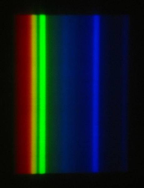

My understanding of it is its an extremely narrow range of wavelengths of the electromagnetic spectrum. You know those orange street lights that are everywhere? They're high pressure sodium lamps and that orange light is sodiums emission spectrum. If you shine a HPS lamp through a prism it won't separate into a rainbow like sunlight does, instead it'll separate into a handful of "spectral lines" which are different colours because they are different wavelengths. Its only when you combine all these wavelengths that you get that orange light that sodium gives off. Every element has its own unique emission spectrum. For example here's a mercury lamp:
as you can see mercury emits that bluish green light. If you shine that through a prism here's what you'd see:
thats mercurys emission spectrum and those bright lines of light you see are called spectral lines. As you can see its most intense spectral line is in the green region of the visible spectrum and its 2nd most intense one is blue. You can also see that they are not single wavelengths of light but are actually bands of wavelengths. Each band is called a spectral line. Heres a sodium lamp:

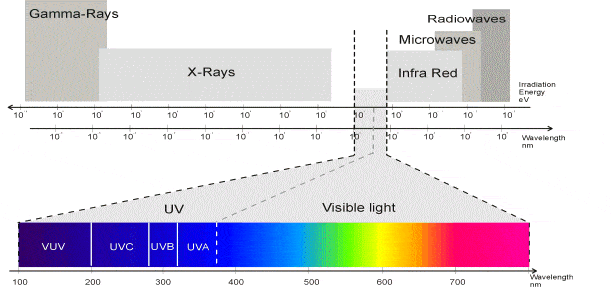

according to that article, the 2 bright orange spectral lines are by far the most intense visible spectral lines that sodium emits. The brightest spectral line is twice the intensity of the 2nd brightest one and the 2nd brightest spectral line is 99.3% more intense than sodiums 3rd brightest visible spectral line. The ones you can see with the naked eye are only the spectral lines in the visible spectrum. Elements like sodium also emit spectral lines that you can't see. For example here's mercurys UV-Vis spectrum:
that intense spectral line at around 250nm is invisible because its in the UV spectrum:
that picture I posted at the top of the thread is a real picture, that's what you actually see when you shine mercury light through a prism. You can see the big crazy green spectral line at around 550nm and the less intense blue spectral line at around 440nm but to see that intense spectral line at around 250nm you'd need a pair of UV goggles.
