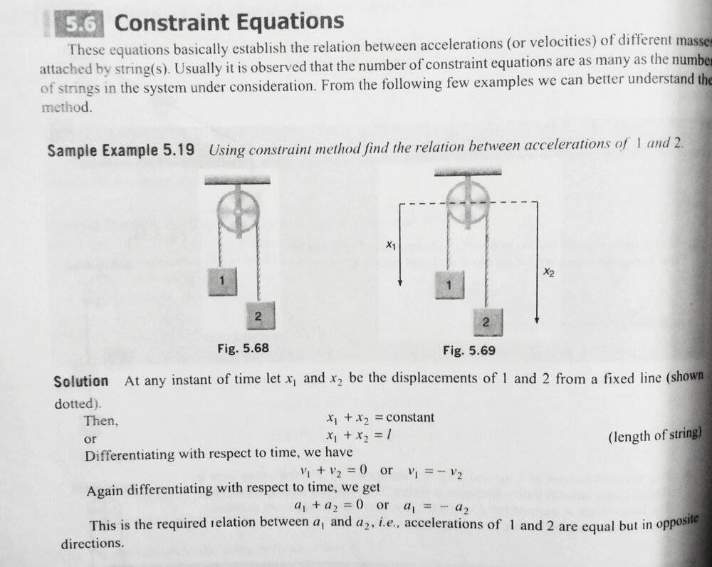

Okay, blocks should move as to maintain the length of strings, but I cannot do further than this. Can you provide a little more hint?
Expand
\frac{d^2}{dt^2} \left(l_1 +2 l_2+l_4\right) $$
Evaluate the terms, using the variables for the accelerations of the blocks.

You could also get the constraint equations by putting the work done by string to zero, and then differentiating twice. This works here because the string is massless.
