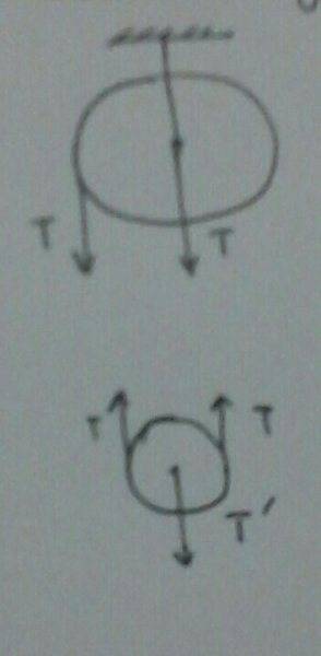

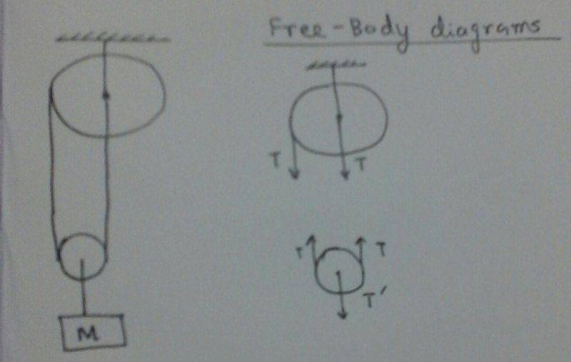

Free body diagrams:
For larger pulley, TR=Iα ⇒ T=½MRα
If this pulley rotates by some amount suchat x length of rope becomes free, and if I hold the smaller pulley at rest, then this extra length of rope comes bellow the pulley. So the small pulley can go down by x/2 distance.
Hence for every θ rotation, the small pulley goes down by Rθ/2.
For smaller pulley, T'-2T+Mg/2=Ma/2 and for block, T'=Ma+Mg
So ssubstituting T', 2T-Ma/2=3Mg/2
Now if rope comes down at a rate of Rα, then pulley goes down by Rα/2
Hence a=Rα/2
After plugging in all values, I am not getting the answer.

OK. Here are a couple of things to think about:
1. The angular acceleration of the upper pulley is not equal to the acceleration of the block divided by R. Kinematically, the tangential velocity of the upper pulley is twice the downward velocity of the block.
2. The two tensions, which you call T, are not equal. There has to be a tension difference in order to rotationally accelerate the lower pulley. You need to do a moment balance on the lower pulley.
Chet

I am not able to find a relation between the three tensions.
OK. You are basically dealing with 4 linear algebraic equations in 4 unknowns.
Unknowns:
1. Tension in the part of the upper rope to the left of the lower pulley TL
2. Tension in the part of the upper rope to the right of the lower pulley TR
3. Tension in the lower rope T'
4. Acceleration of the block a
Equations:
1. Moment balance on upper pulley
2. Moment balance on lower pulley
3. Force balance on lower pulley
4. Force balance on block
In my judgement, the complicated part of this problem is not in setting up the force and moment balances. It is in establishing the kinematics. Please summarize for me again, in terms of the acceleration of the lower pulley a, what you got for
1. The angular acceleration of the upper pulley αU
2. The angular acceleration of the lower pulley αL
Chet
New equations:
1)torque equation for large pulley
##T_1=1/2MR\alpha##
2)torque equations for small pulley
##(T_2-T_1)R/2=\frac{1}{2}\frac{M}{2}\frac{R^2}{4}\alpha_1##
##T_2-T_1=\frac{MR^2\alpha_1}{8}##
3)Force equation for block
##Mg-T_3=Ma_1##
4)Force equation for small pulley
##T_3-T_1-T_2+Mg/2=Ma_1/2##
5)Relation connecting ##\alpha_1## and ##\alpha_2##
If Rθ string comes out, then the pulley moves down by Rθ/2.
And i know that if lower pulley rotates by 2π, it moves a distance of 2πR/2 since radius is R/2.
To move a distance of Rθ/2, the pulley has to rotate by ##\frac{2\pi}{\pi R}.R\theta/2=\theta##
So if upper pulley rotates by θ, then the lower pulley also rotates by θ?
Yes. Everything is correct.
So, in your notation, ##α=α_1=\frac{2a_1}{R}##
Chet
Now ##T_1=1/2MR\alpha##
##T_2=T_1+1/8MR\alpha=(5/8)MR\alpha##
##T_3=Mg-(1/2)MR\alpha##
Now ##Mg-(1/2)MR\alpha-1/2MR\alpha-(5/8)MR\alpha+Mg/2=(1/4)MR\alpha##
Got the answer. Thank you for helping.:smile:
