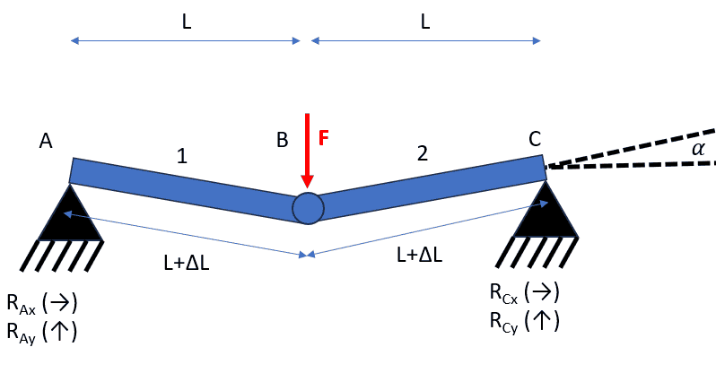

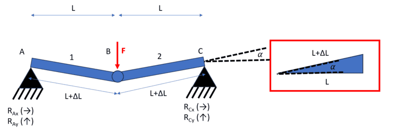

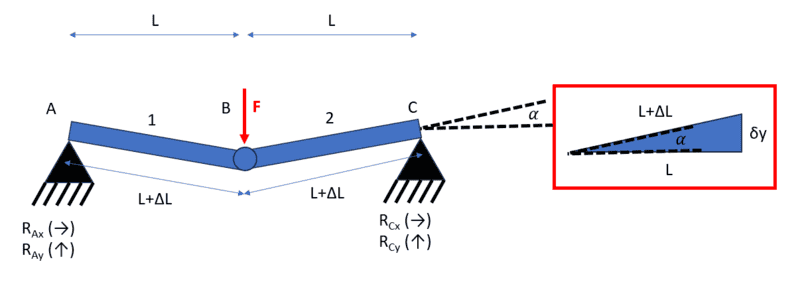

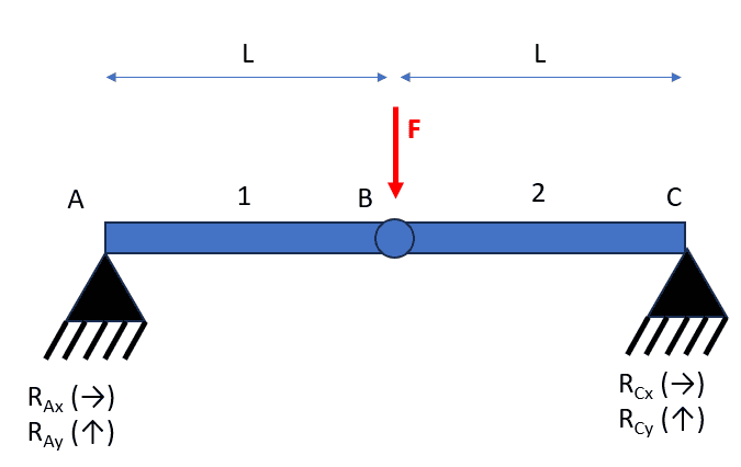

Let's start with a simple example.
This problem is statically undetermined because the 3 equations of equilibrium are not enough to find the reactions but that's not the point. The point is that those rods can only work axially because it's a truss with forces only in the articulations so to counteract ##{\color{Red} F}## that has a vertical component (and only a vertical component in this simple example) they will need to change their orientation so that the axial internal forces have a vertical component too.
The problem can be solved by finding the relation between the internal axial forces in the beam and the deformation of the system.
Now using the equilibrium of vertical forces at the joint B it is possible to find the reactions, internal forces, elongation, and the angle the system will adopt.
##\sum F_y=0 \rightarrow -F+N_{1_y}+N_{2_y}=0 \left \{ Symmetry \rightarrow N_{1_y}=N_{2_y}=N_y;N_y=Nsin(\alpha);N=k\Delta L\right \} \rightarrow##
##\rightarrow F=2k\Delta L\sin\alpha##
That's still not enough because in that equation we don't know 2 variables ##(\Delta L, \alpha)##. However, it is possible to link them.
##(L+\Delta L)\cos\alpha = L\rightarrow \Delta L = \frac{L}{\cos\alpha}-L##
Then, by combining the two previous equations, it is possible to have only 1 variable to solve.
##F=2k\Delta L\sin\alpha\rightarrow F=2k(\frac{L}{\cos\alpha}-L)\sin\alpha\rightarrow \frac{F}{2KL}=\tan\alpha-\sin\alpha##
I'm pretty sure that trigonometric equation cannot be solved analytically so I will leave it there. The point is that it can be solved and the system is fully defined. As a sanity check, as ##\alpha \rightarrow 0## it seems like the equation fails. However, if ##\alpha \rightarrow 0## is because then ##k\rightarrow \infty ## so we have a ##\infty \times 0## situation which can spit ##F## as a result.
So the problem is solvable. However, the procedure is very different when comparing it with the linear problems we typically see in books on Static and Resistance of Materials. Even for this simple case, I'm not certain I could solve it if I got rid of all the symmetries. Is there an established way to solve these types of problems/structures?

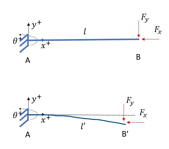

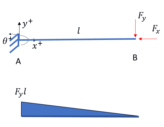

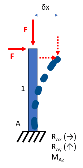

Another case that could be interesting to solve is the following
I don't know if that's related to how the formulas for buckling are derived but I doubt it because when checking for buckling, at no point the reaction moment ##M_{A_z}## is considered. Is this maybe an alternative way of checking for buckling? The point is that as ##\delta x ## increases, the reaction ##M_{A_z}## needs to grow as well to compensate ##F \delta x## so we have a problem where again the reactions depend on the displacements. I tried solving this problem with no luck so far.
Do you know the standard procedure to solve it? Or books that cover this?
This is a case of a beam under combined axial and transverse loading (Beam-columns). The displacement formula for your specific case can be found in Roark's Formulas for Stress and Strain. Techniques for analyzing these types of problems can be found in textbooks on Advanced Mechanics of Materials (e.g., Cook ang Young's book)

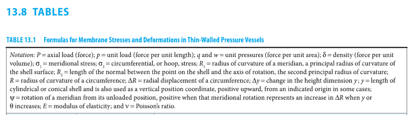

I just read Chapter 12 in Roark's and at no point, it mentions the displacements and how the reactions depend on it.
I'm sure the information in there is of big importance but it's not what I'm looking for.
In Chapter 15 I could find some information more directly related to the original post.
After reading the chapter I still do not know how to solve the problem but at least now I know the name of the area that covers this kind of thing.

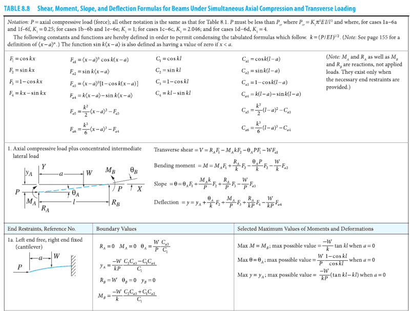

In Roark's book, there should be a section on "Beams Under Simultaneous Axial and Transverse Loading." If P is the axial load and W is the transverse load at the end, then the transverse end deflection is
y=W/(k*P)*(tan(kL)-kL) where k=(P/(EI))^(1/2) and L is the length of the beam.
I just checked section 8.7 BEAMS UNDER SIMULTANEOUS AXIAL AND TRANSVERSE LOADING and I couldn't find the formula you mention.
Are we maybe seeing different editions?

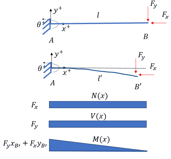

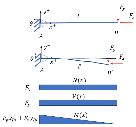

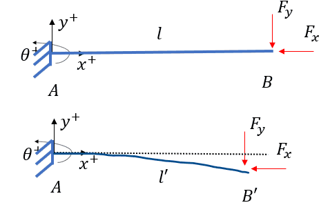

I think I have some new insight into this problem.
The problem would be solvable in time if the elements were capable of dissipating energy. It'd be done by a computer with FEA but I don't have access to that and I also think it'd be computationally expensive so I'll ignore that approach. I did something similar once to calculate catenaries in Python and it's not nice.
For quite a while, I have been thinking about solving it iteratively, but I don't think that converges because the leverage will be greater in each iteration.
Today I was reading the wiki page for Euler's buckling and I gave it a shot although I cannot solve it entirely. By the way, after seeing the derivation for Euler's buckling, I realized it looked similar to what I posted originally. The point is to assume the deformation and write equilibrium in the deformed state.
Making equilibrium in the deformed state around A:
$$M_A - F_yx_{B'} - F_x y_{B'}=0 $$
For that, I'd need the coordinates of ##B'## for which I'd need to know the deformation beforehand. It's kind of a vicious circle. The way I think to break it is by using the bending diagram and assuming the simplifications given by the Bernoulli-Euler beam formulation, it's possible to find the new ##y_{B'}##.
Note: Those simplifications imply ##x_B=x_{B'}=l##. That is impossible but the point is to simplify the problem by only calculating the factors with the greatest impact.
$$M(x)=-EI\frac{d^2y}{dx^2}$$
From the bending diagram, ##M(x)## can be obtained.
$$M(x)=C_1x+C_2$$
$$M(x=l)=0$$
$$M(x=0)=F_y l + F_x y_{B'}$$
Solving the system of equations.
$$M(x)=-\frac{F_y l+F_x y_{B'}}{l}x+F_y l+F_x y_{B'}$$
Finally, combining that with the previous expression relating bending and deformation:
$$-\frac{F_y l+F_x y_{B'}}{l}x+F_y l+F_x y_{B'}=-EI\frac{d^2y}{dx^2}$$
And that's where I don't know how to continue because ##y_{B'}## is not just ##y##. If that were the case, it'd be a differential equation that I wouldn't know how to solve either right now but I'd be more familiar with it. The problem is that ##y_{B'}## is the value taken by ##y## at ##B##. Mathematically expressed it'd be ##y(x=l)=y_{B'}##.
Do you think this approach to the problem makes sense?
If so, do you know how to tackle such a differential equation?

The value of ##y_{B'}## is unknown but it must be just a number because it's evaluated ##y(x=l)=y_{B'}## so I could treat it as a constant. It means I can solve the differential equation as usual.
Then, using boundary conditions, I know the displacement and slope at ##y(x=0)## which will give me two equations. But I'm still missing one equation to be able to find the last unknown ##y_{B'}##.
In your cantilever beam example, you did not get the internal bending moment quite right because you assumed that it was simply a linear function of x. I suggest that you get the moment by cutting the beam at some position x and drawing a free body diagram. This will lead to the following expression for moment
M(x)=-F_x*(y_B-y(x))-F_y*(L-x)
This will give you a differential equation for y(x). Then solve the differential equation using the boundary conditions
At x=0, y=0
At x=0, dy/dx=0
At x=L, y=y_B
This is not too difficult, but the algebra gets messy.

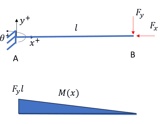

I think you're right on that. I assumed it was linear because of the following relations:
$$q(x)=\frac{dV}{dx}$$
$$V(x)=\frac{dM}{dx}$$
So with ##q=0## then M must be linear. Those equations are derived from making equilibrium in a differential size element.
NOTE: I used different letters to describe each term than what's shown in the picture.
However, making equilibrium in the deformed state and cutting it at ##x## I get an expression like yours.

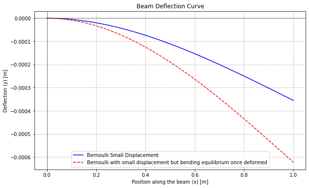

I couldn't solve it analytically because the computer wouldn't let me (stack overflow for some reason). Inputting the expressions from @T1m0 felt like cheating so I solved it numerically.
I had to modify some signs here and there but the results make sense although I haven't figured out a way to check if they are really correct.
Here is the code

# Check if the solver was successful
if sol_bvp.success:
y_B = sol_normal.y[0,-1]
y_B_1 = sol_bvp.p[0]
y_vals_bvp = sol_bvp.sol(x_vals_bvp)[0]
# Plotting the deflection curve
plt.figure(figsize=(10, 6))
plt.plot(x_vals_normal, y_vals_normal, label='Bernoulli Small Displacement', color='b')
plt.plot(x_vals_bvp, y_vals_bvp, label='Bernoulli with small displacement but bending equilibrium once deformed', color='r', linestyle='--')
plt.title('Beam Deflection Curve')
plt.xlabel('Position along the beam (x) [m]')
plt.ylabel('Deflection (y) [m]')
plt.axhline(0, color='black', linewidth=0.5)
plt.axvline(0, color='black', linewidth=0.5)
plt.grid(color='gray', linestyle='--', linewidth=0.5)
plt.legend()
plt.show()
print(f"Solved deflection with small displacements at x=L (y_B): {y_B}")
print(f"Solved deflection with bending equilibrium once deformed at x=L (y_B): {y_B_1}")
else:
print("Solver did not converge:", sol_bvp.message)[/CODE]
Actually, there is a fairly simple analytical solution in Roark's Formulas for Stress and Strain book; i.e.,
y_B=(F_y/F_x)*(k*tan(L/k)-L) where k=sqrt(E*I/F_x)
Could you tell me where you found it? I feel like that book contains everything but I never seem to be able to find what I'm looking for. And, if for any reason I find it, there are no explanations about it so I don't understand it.
By the way, I'm planning to add some graphs to this plot:
Juanda said:
  1. Deformation calculated "the normal way". This is using equilibrium in the undeformed state and Bernoulli with small deformations.
    $$M(x) = -F_y(L-x)$$
    That's what's already shown in blue.
  2. Deformation calculated with equilibrium in the deformed state (cutting the beam at ##x## to make a free body diagram as proposed by @T1m0 ) with Bernoulli and small deformations using a numerical solution.
    $$M(x)=F_x (y_B - y) - F_y (L - x)$$
    Notice I had to change a sign in ##M(x)## with respect to what is shown in #12. Otherwise, the deflection was smaller than in the "normal" case. I assume it is because of some sign convention and the definition of the reference frame.
    That's what's already shown in red.
  3. Deformation calculated with equilibrium in the deformed state (cutting the beam at ##x## to make a free body diagram) with Bernoulli and small deformations using the analytical solution to the differential equation and system of equations for the boundary conditions shown in #9 and #13 by @T1m0. If point 2 is correctly solved, it should yield the same solution.
    Pending.
  4. Deformation calculated with equilibrium in the deformed state (cutting the beam at ##x## to make a free body diagram) with Bernoulli and small deformations using the analytical solution to the differential equation but using the information regarding the boundary conditions supplied by Roark's. Again, it'd give the same result as points 2 and 3.
    Pending.
  5. If I still have some energy in me, I'll try to implement the large deformations as suggested by @erobz in #10.
    Pending.
The solution in Roark's book can be found in the chapter on Beams in the section for "Beams under simultaneous axial compression and transverse loading." The complexity of the expression depends on which edition of the book that you have. The later editions are more difficult to decipher than the early ones.
Regarding sign conventions, most Mechanics of Materials books take the convention that positive internal bending moments are those that tend to make the beam "smile." When drawing the free body diagram for a cut section, always draw the moment going that way and let the moment equilibrium equation dictate the sign of the moment that is calculated. Next, equate this to the negative of the product of EI and the second derivative of displacement.
As a structural engineer, I suggestion is to look into the finite element method. The stiffness matrix for beam elements is well defined and can easily be implemented using Python, Matlab, Julia etc... Furthermore Gridap presents an approach where the weak form of a differential equation can be used solve differential equations using the finite element method. https://github.com/gridap/Gridap.jl
To be clear, are you referring to case 1a shown in table 8.8?
(Roark's Formulas for Stress and Strain 9th edition)
In that case, it's the right side the one that's fixed instead of the left one as I drew but I can mirror the results later. Also, to adapt it to our case I'd make ##a=0##.
I am surprised by these formulas because the book must be doing something similar to what you showed (calculating the bending moment once deformed to find equilibrium). After all, the deflection would otherwise take a polynomial form but the book shows trigonometric functions.
I have a couple of questions on how to interpret what's shown in the formulas.
  1. What's this operation ##\left<x-a \right>^n##?
  2. When it's saying ##\cos k (l-a)## it means this ##\cos (k) * (l-a)##, right ?
    Pending.
    Pending.
    Pending.
I have calculated the vertical displacement of the node at the end using Roark's as mentioned in point 4 and it gives the same result as point 2 as expected. The difference in results is 6.283450322552842e-14 which comes down to the precision of the computer and the numerical approach used.
Point 3 I'd say is not relevant anymore.
Point 5 is still the one that could be interesting to invest some more time on it although I don't know how I'd do it now.
