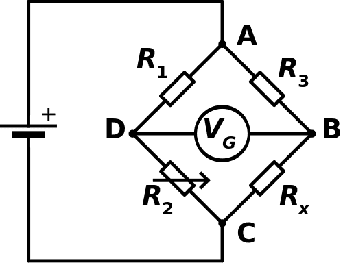

You are given a standard Wheatstone bridge, prove that the bridge is balanced if and only if [tex]R_x = R_3 \frac{R_2}{R_1}[/tex]. Subindexes depend on the names assigned to each resistance. Proving that if the bridge is balanced THEN the resistors satisfy said relationship is easy, I am having prouble proving that IF [tex]R_x = R_3 \frac{R_2}{R_1}[/tex] then the bridge is balanced.
Circuit schematic of a Wheatstone bridge: a battery on the left feeds a diamond network with corners A (top), B (right), C (bottom) and D (left); resistors R1 (A to D), R3 (A to B), R2 (D to C) and Rx (B to C), with galvanometer VG between D and B.
I have been trying to prove this using Kirchoff's laws around as many paths as i could find, but I am getting nowhere.
